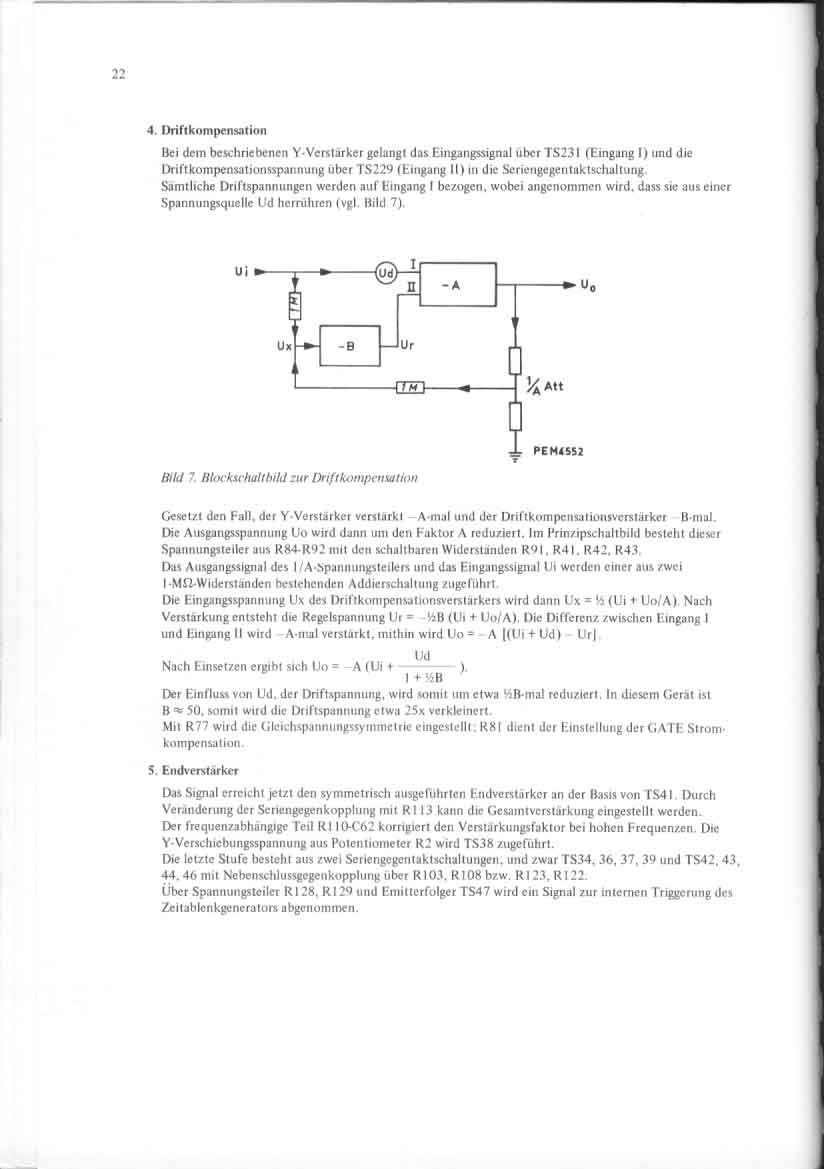

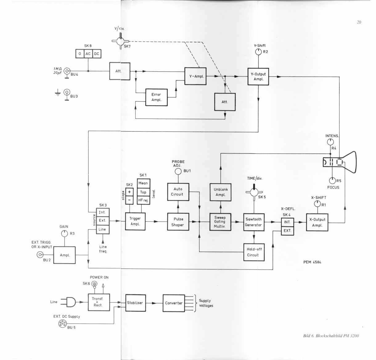

I found some more schematics for PM3200 But, it is in German. I converted to PDF from JPEG Files.

Lets try to upload it again the file is 1.8Mb and it will not accept it. the allowed size of a PDF is 9.5Mb. I can't understand why it will not accept it.
