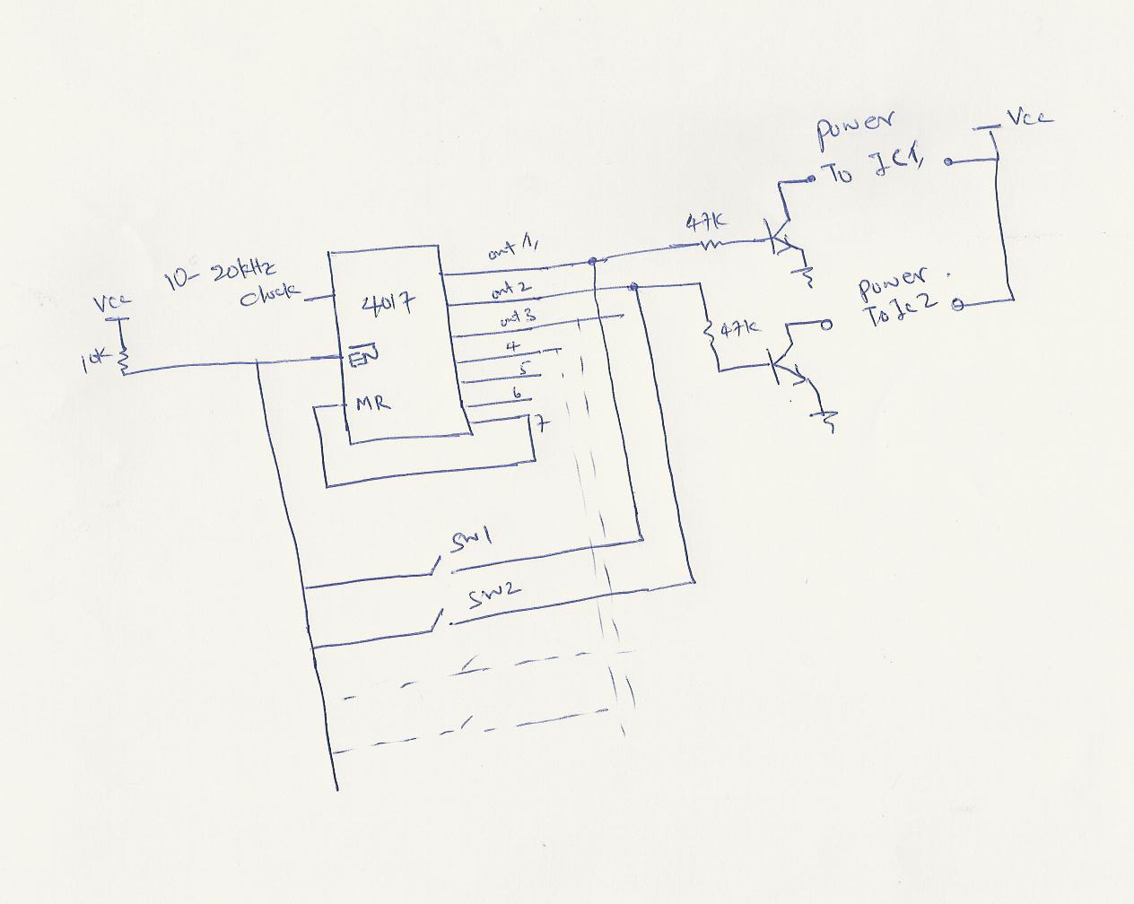

use transistor switches for each ICs, 4017 can be used in such a way to function as you wish ie: will roll and latch at the last switch pressed,to turn on the particular switching transistor. i have long before done such a design using it, shortly i may post it for you.
I was thinking of the 4017 as well but
the sounds would be in same order each time regardless of pressed button

4017 will do it
yes you are correct it will follow the same order, but what if you use a high frequency clock? you will not feel the suden change, see the diagram i have attached, hope it would work as a latching switch only one at a time, i have built it and used it long before for a slector switch application. just try

Thanks for that circuit, I think that may do the trick.
I'm going to trigger a 555 from the selected output of the 4017 which will power up the associated sound IC and hold the enable of the 4017 high until the sound IC is finished playing, that way if another switch is pushed while the selected sound IC is playing it will have no effect.

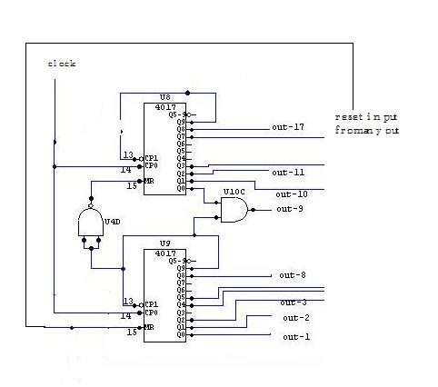

Now, if I want to use more than ten pushbuttons and sound IC's is there a way I can cascade two 4017's ?
Thanks for the help.

correct, just see the attached diagram how you can connect more then one 4017, you can make any number cascaded.
