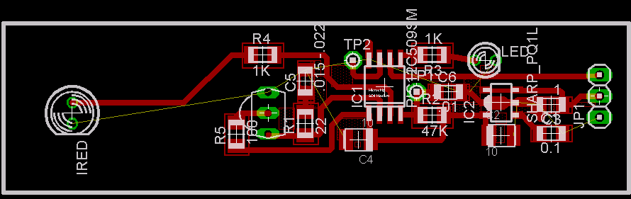

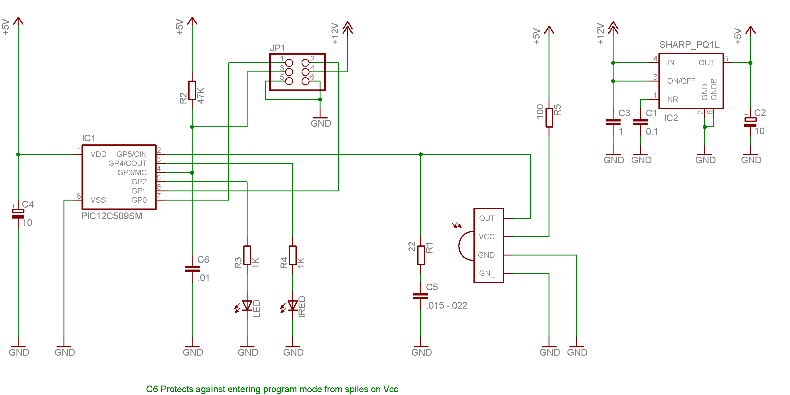

Here is a circuit I have posted here before. It works at short distances, I am not sure how far away you need to detect the reflected IR. I also have a 555-based design, without the error correction that the 12F509 allows. Let me know if you want it.
It is modified from this source:
http://users.frii.com/dlc/robotics/projects/botproj.htm
Edit: Board dimensions are 0.65" X 3" -- I wanted it to fit inside a square metal tube.
