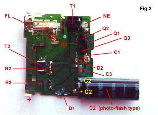

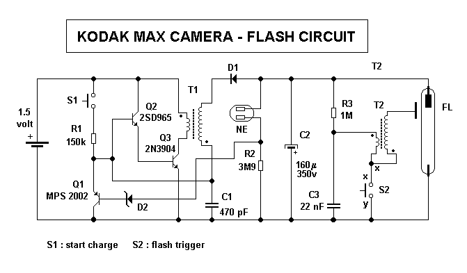

You need a few more items... See the attached circuit for a disposable camera flash.

Can this be simplified? For example, to only charge when a button isn't pressed then discharge when the button is pressed?
Also, the fuse sensor thing (shown as a line parallel to the flash bulb and a piece of metal in real life) is only used as a safety precaution. Am I right?
The flash circuit from a disposable camera is as simple and as cheap as is possible.
The circuit steps up the 1.5V or 3V from the battery to about 320V to charge the big capacitor. Then when the button is pushed it makes a few thousand volts spike.
The line parallel to the flash tube is the trigger wire that has a few thousand volts spike in it to ionize the gas in the flashtube so it can begin to conduct.

A kit might be a better idea, you get all the parts and a PCB.
This circuit is a low voltage oscillator that makes AC. The AC has its voltage stepped up by two transformers. A rectifier diode changes the high voltage AC into high voltage DC that charges the big capacitor.
There is no amplifier.
The transformer is specially made for the flash circuit.
Buy the kit or go to a store that prints photos and ask for a disposable camera's circuit that they throw away.
