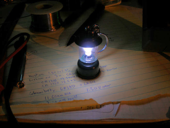

So here’s the real problem and why the constraints are as they are. Over the Holidays everyone in the family got these “stocking stuffers” – miniature Coleman Lantern LED key fob lights.
Now the original designers decided to use 2 cheap 1.5V batteries, either GP189’s or 389A’s. So with 3V they couldn’t use a bright white LED, but had to use a very dim amber/yellow LED that was completely worthless.
So I took one of the lanterns, found 2 3V button batteries that would fit close enough – the 1025’s, a bright white LED and fit a 100 Ohm resistor thanks to a Dremel. Works great – bright and useful light.
And yes the 1025’s each cost as much as the entire lantern – but what’s a few bucks among family.
Probably won’t last long, but may be similar to other typical overpriced key fob LED lights that use 2 2016’s.
What led to the OP was my interest in finding a more efficient longer lasting way to drive the LED given these constraints. I figure I could drill out enough space to add something in a TO-92 package. Would regulating the current give me a longer useful life?

Inside the lantern there is room for perhaps 6mm depth, 12mm diameter.
A picture would help.
What about AAAA batteries then?
It looks like a very small lantern. How long was the LED bright? Could you see it dimming?
