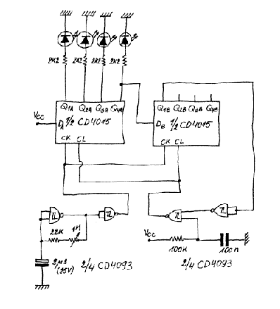

Hi Steve,
Add six extra CD4015's and connect them all as the second
half of the CD4015 is connected to the first half. Connect
all clock and all reset inputs together and move the reset
which is connected to Q1B to Q3M. (from the seventh CD4015)
That's it.
on1aag.

The man specifically asked for a line of 50 leds, this would mean
a total of 1275 diodes. The last transistor doesn't actually need
a diode, 1274 diodes will do ! :D
on1aag.

Hi Charlie,
You're wrong again, if you insist on using a 4017 you gonna need OR
gates to drive the transistors. For the first transistor you need one
with 10 inputs, for the second one you need one with nine inputs,
shall I go on ?
What's wrong with my circuit ?
light-chaser-984-gif.13410
on1aag.
