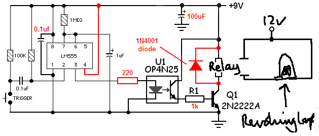

Edit: I got it to work.....simple case of a short circuit.....I used the circuits below BTW...
Here is the 555 circuit I used, using a 9v battery.
And here is what I used for a different application, using a the 4N25 on the outputs to trigger a revolveing light as an indicator, wheras in the newer application I want it to trigger the remote.

Your circuit needs a supply bypass capacitor to keep the voltage from jumping all over the place.
It looks like you did not have a resistor in series with the LED in the opto-isolator so its LED burned out.
Then you added another LED that doesn't activate the photo-transistor inside the opto-isolator, then it also burned out. Maybe the output transistors of the 555 also burned out.
The transistor that drives the relay is probably destroyed by the hundreds of volts that are generated by the inductance of the relay coil when it turns off, because you forgot to use a clamp diode across the coil.
Your circuit does not have a latch so the revolving light would work only for 1 second anyway.

I don't know why you have two supply voltages.
I don't know why you are using an opto-isolator.
I don't know why you use a relay instead of a power transistor or Mosfet to drive the rotating light.
I added a 0.1uF supply bypass capacitor at the 555 and added a 100uF supply bypass capacitor for the entire circuit.
I connected the reset pin4 of the 555 to the positive supply.
I calculated 30mA through the LED in the opto-isolator then added a series 220 ohm current-limiting resistor.
I reduced the value of the resistor supplying base current to the 2N2222 to make sure it switches on very well.

I have tried that circuit today, but I cant seem to get it to work.
There is a voltage at the Opto when I trgger it, that reads for a second, but its not latching the relay on the other side at all.
I see you asked those three questions at the beggining of your answer, but can you suggest a bteer way for me please?
All I need is for the 555 to trigger a pulse to switch another circuit on for 1 second, or is there a way of outputting 9v from the 555 to power directly?
The circuit is supposed to turn on the relay for only 1 second. It does not latch.
If the relay does not activate for 1 second then something is destroyed or connected backwards.
Your original schematic shows a missing current-limiting resistor in series with the LED in the opto. Then the LED is probably burned out.
If you tried the circuit without the diode then the high voltage probably destroyed the transistor and maybe also destroyed the opto.
If the diode is connected backwards then the transistor is probably destroyed.
Why do you want the revolving light to operate for only 1 second?
