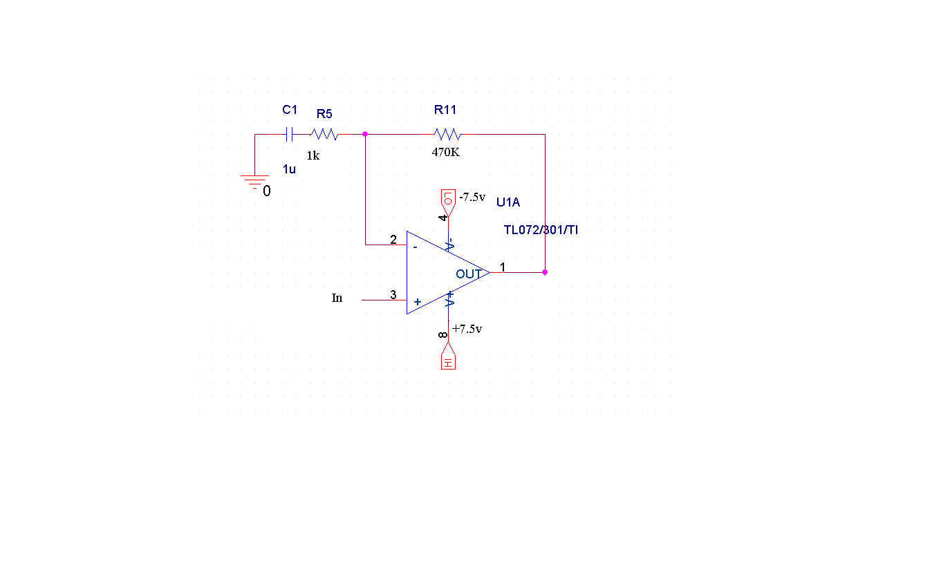

Please tell me if the below circuits are satisfied at audio frequncies?
I looked at the datasheet of the TL072 but I was not able to find out if this config and specially those two gains showed below satisfy the TL072 main parameters?
Actually I do not know which parametrs should be considered other than the power supply volatge?

by the way any idea how to have the 180 degree of the output signal? I think adding another op-amp on inverse config would do so but do not know the actual configuration.

Your gain is way too high. For an op-amp to amplify an audio audio signal, then you need to have an op-amp with a gain of 11 or less. Use a 10k feedback resistor (R11) and connect another 10k resistor (R5) to ground. To find out the minimum input voltage for your op-amp it would be found in the data sheet as the differential input voltage.

The above config would be used as a mike amplifier, so I need a gain of more than 100. What will happen if I incrase the gain? Any problem?

Your first opamp has a gain of 101 (1M/10K +1). Its 10k resistor and 1uf capacitor to ground reduces the gain of frequencies below 16Hz.
The datasheet has a graph shoing the high frequency rolloff of high frequencies when the gain is changed. With a gain of 101 then its high frequencies are reduced above 30kHz.
Your second opamp has a gain of 471 (470k/1k +1). Its high frequencies are reduced above 6400Hz.
Your circuit is non-inverting. If you want it to invert then make an inverting opamp circuit.

Well first I'd like to appalogize, it wasn't the differential input voltage, it was the input offset voltage, which was between 3mV and 10mV. So that would be your minimum input voltage. You may need to make a preamp before connecting the mic to the op-amp.

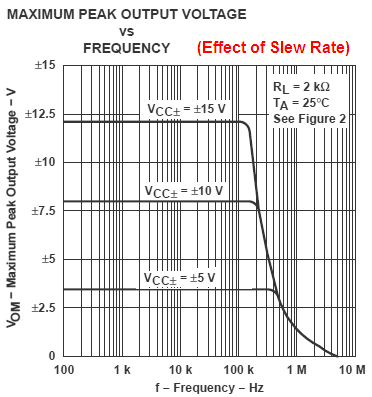

What about Slew rate?

A mic preamp amplifies the AC signal, not the DC odffset voltage. Mic preamps work with input signal levels of microvolts and the noise level is what limits the smallest signal level.
No.
The opamp is the preamp.

Low level audio creates a signal of only microvolts at the output of a mic so the gain must be 200 to 300.
Your gain of only 6 is used when you are screaming at a mic that is touching your lips or inside a drum.

A 1uF capacitor has a reactance of 10k ohms at 16Hz. But the gain of the opamp is Rf/R to ground. R to ground is 10k ohms. The reactance of the capacitor is increasing R to ground so the gain is -3dB at 16Hz.
The slew rate is shown on another graph on most opamps' datasheets. It is the frequency where the output of an opamp cannot slew fast enough to produce a sine-wave and instead produces a triangle-wave with the output level dropping if the frequency is higher.
A lousy old LM324 or LM358 has trouble above only about 2kHz. A lousy old 741 opamp has trouble above only 9kHz. The TL072 works perfectly up to 100kHz.

Ok audioguru, I want to do so but which cobgigration is the best choice to deal with? I want my config (at the first post) to be the secod stage, But not sure which configuration is the best choice for the first stage? My electeret Mike has a insuded battery for its bias too.
The other pont is that I need to provide a DC offset in the input for some reason (I did it by a 10K pot on the non inverting of my circuit which is showed at post NO 1).
