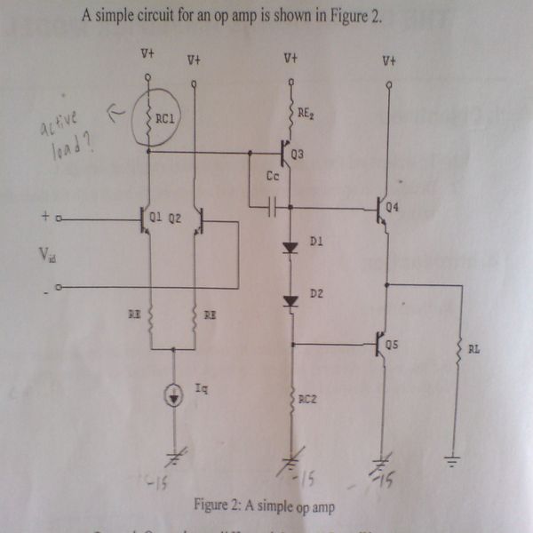

i am designing an opamp to obtain open lop gain of 4000.i arrive at the second one.can somebody provide me the real circuit to replace the current source?and can you show me the connection to measure open loop gain?
circuit source: Ron H from allaboutcircuits.com

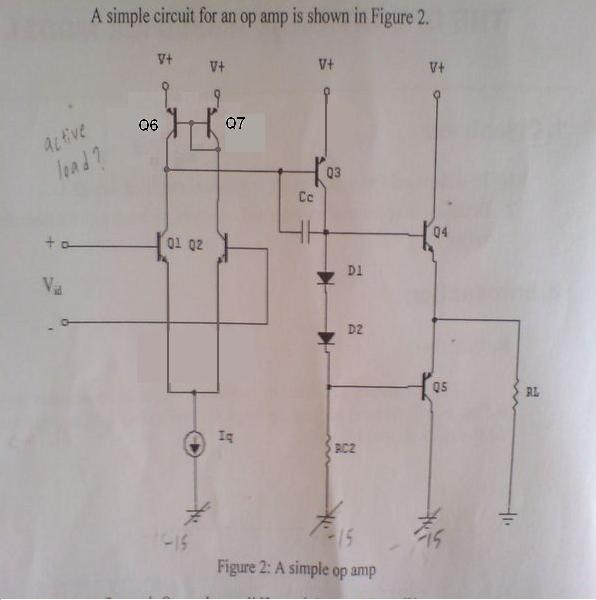

The output of your first stage should be connected to Q7/Q2. For the current, look up "current mirror." That method only works well as an integrated circuit, or you can find a matching transistor pair.

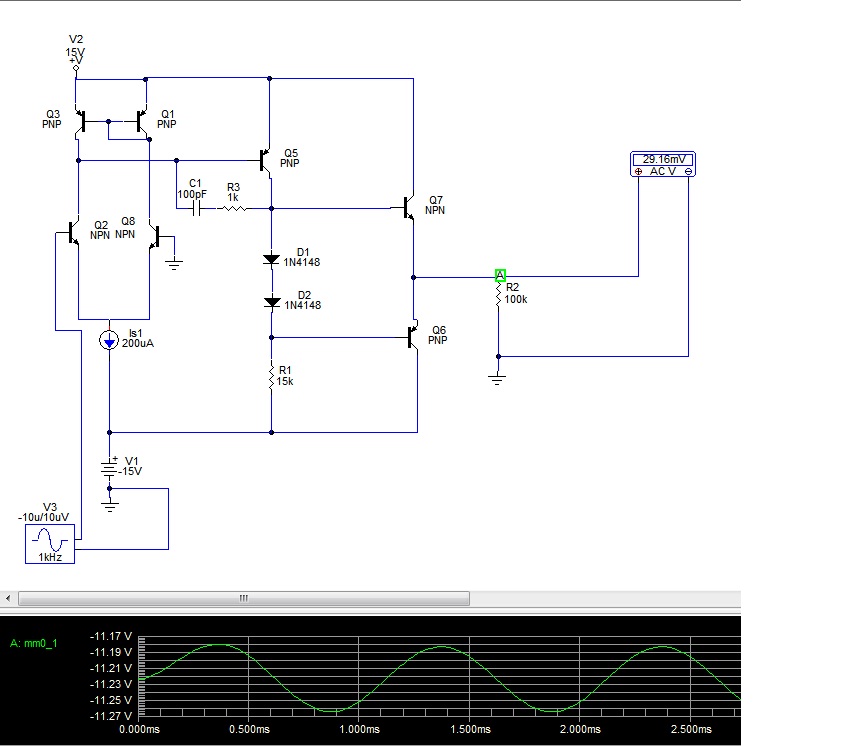

i connect like this to measure open loop gain ,is it correct?but i only manage get gain of 100 (7/0.0707).can you help me check whether the circuit is correct or not?

Your test method totally won't work. Your operating voltage is not applied correctly. Also, there seems to be a connection missing betweeen Q7 and Q5.
You negative -15V power supply is wrongly shown as a positive +15V supply.
sorry,my bad.there really got connection.i simulate it and get such value.29.16m/7.07u=4124,so the circuit is correct for gain 4000?
It only works through the "magic" of simulation. This would never work in a real circuit.
First, connect the operating voltage correctly. Look over this discussion to learn how. The simulation works, but in the real world, a 10uV source doesn't exist. Use the link I provided to see how to do this correctly. If this is just an exercise in "theoritical" imaginary electronics, you're probably done.
