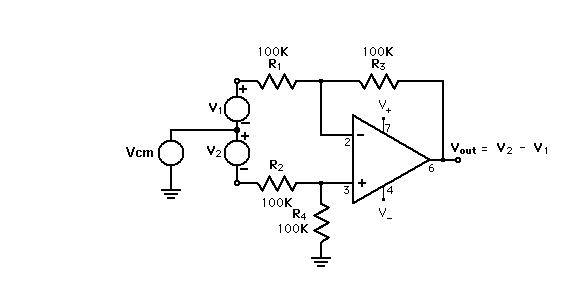

I keep seeing this difference amplifier setup:
http://hyperphysics.phy-astr.gsu.edu/hbase/electronic/opampvar6.html
But never this one (image attached). It's basically a modified non-inverting amplifier where the reference is a voltage other than ground. Is there a reason for never seeing this circuit and always the first circuit? It seems to me both would work...why does it seem one is usually spoke off and the other one isn't? I need more of a "voltage de-biaser+amplifier" but I'm don't think that's any different from a difference amplifier where one input stays constant.

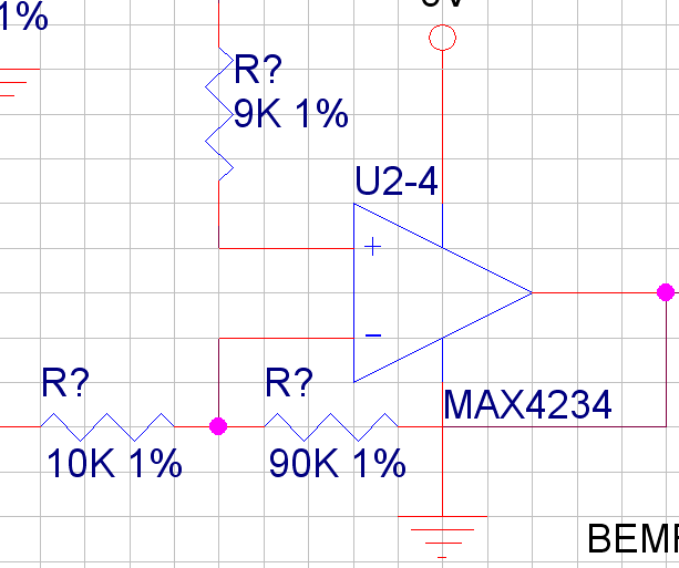

I think it's all there. I just cut out the part of the amplifier. , POwer temrina,s two inputs, and output. I can post the whole schematic if you want but then it's pretty big...The inverting input goes to a non-ground voltage (supposed to remove the bias in the signal at the non-inverting input), and the 9K on the non-inverting input is just for bias currents.
I think what I'm asking, is how is a non-inverting amplifier that has been biased any different from the difference amplifier circuit shown?

I get the gain of my circuit to be G(V1-V2). Doesn't that get rid of any common mode signals anyways? THat equation is the same for the difference amplifier too (exept that G is calculated differently). THat's what I'm confused about, they both seem to do the same thing to me...
Or is that the reason you pointed out? THe input impedances for the + and - terminals are different? 9K = 10K||50K, Wouldn't that correct it?
(V2 is a my DC bias to be removed and not ground like a regular non-inverting amp).

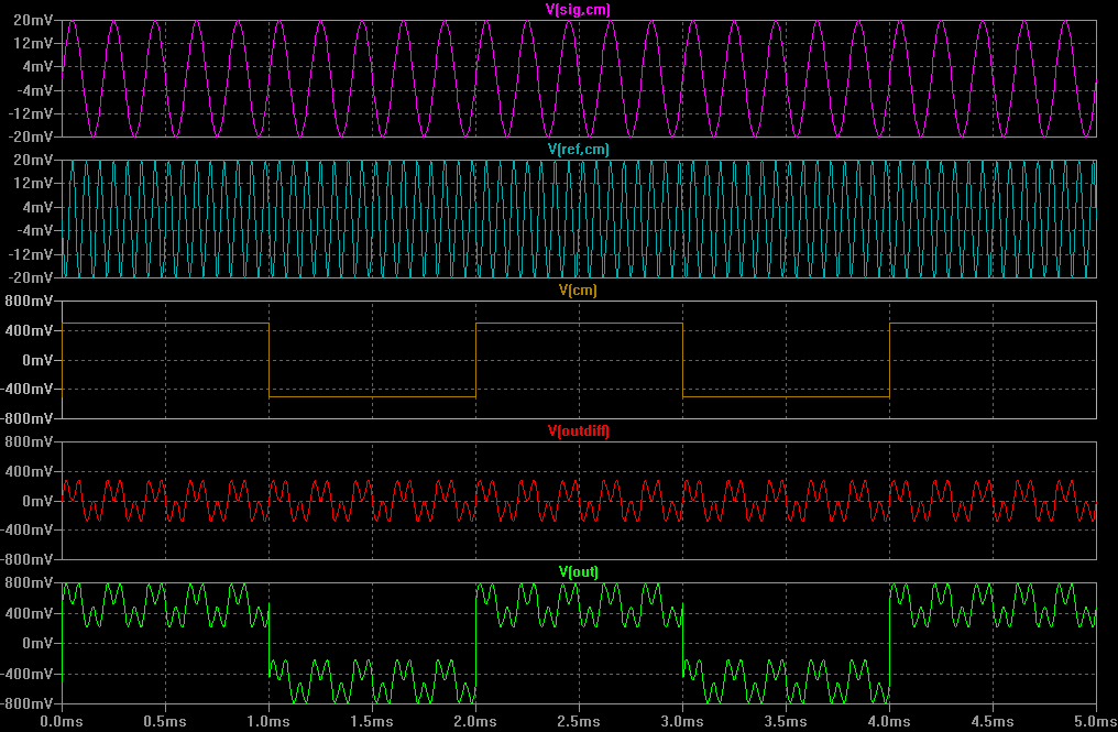

EDIT: Correcting your equation,
10*(Sig+CMN)-9*(Ref+CMN) = 10*Sig - 9*REF+CMN

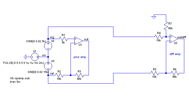

Maybe a visual aid will help convince you even more... :D
