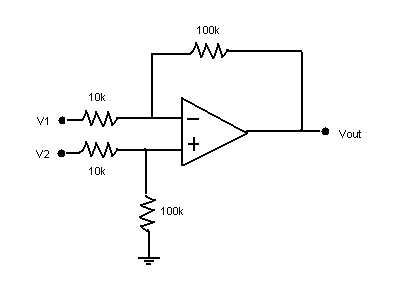

I am new to Op Amps so could anybody help me with a question regarding this please.
I need to create a circuit wherethe output is ten times the difference between its two input signals. I think this could be realised using just two operational amplifiers and five resistors.
could anybody help please??? :lol:
Only one opamp is required, and four resistors.
Like so:
Sorry I forgot to mention the equation I would like to base my circuit around.
Vo=10(V2-V1)
Would a second op amp be required to get rid of the -
Yes, you could use an inverting amplifier, with a gain of -1, on the output of the above circuit.
Or you could just swap the inputs.
The circuit Phasor posted has the gain you want. No inversion is required.
