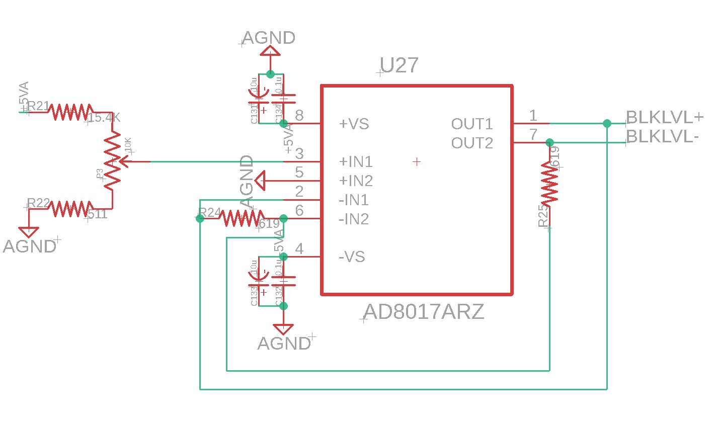

I have a layout as shown in the schematic attached. As soon as I power it on, the IC (AD8017) gets super hot to touch, with a FLIR camera, I am reading ~104C when I turn the 10K pot all the way to the top (+5V) and jumps to ~144C when I turn it all the way down (to GND)
This schematic is used to have an adjustable range at the outputs ±LVL with ±2V being max.
Any suggestions?

It is working as it should, but those temperatures are a bit uncomfortable to keep using.
I checked again and the power supplies are conencted properly, positive on Pin8 and negative on Pin4
It could be a stability problem? It is a very high frequency amp & could eg. be oscillating at tens of MHz.
As it appears to be a low frequency application, try adding a small plastic film or ceramic cap across R25?

Just to add to this, I replaced R24/25 with 10K with same results, but havent tried with a capacitor. Do you suggest a 0.1u or 0.01u in that range?
What is the supply voltage(s). +/-5V?
What is the load? 75 ohms to ground?
Supplies are ±5V, I see these temps even when there is no load connected. But to answer your question, the ±outputs are connected to 4 10K pots in parallel with their wipers connected to LT1014 positive pins

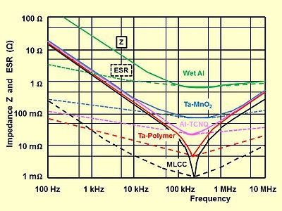

Page 14 layout considerations followed ? I found when working with BW of this
magnitude I had to qualify the ceramics for actual performance. Using a 50
ohm jig and scope evaluated ESR, found wide variations between manufacturers.
I also notice datasheet recommendations of .1uF and Tant did not include .01 uF
ceramic. Their ESR curves broaden the effective bypass range.

Cap technology ESR freq performance key (even in bulk parts) -

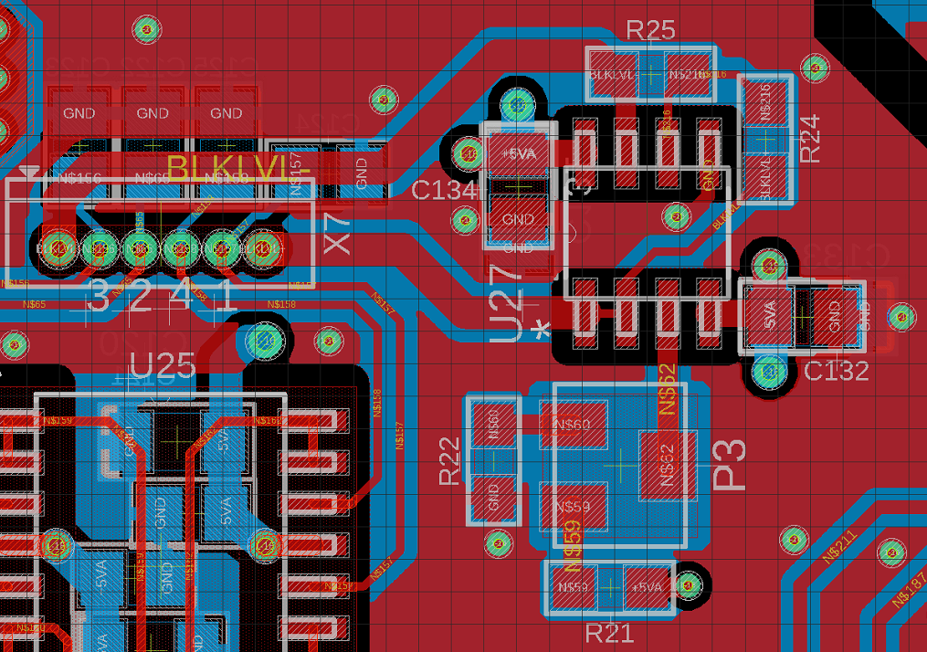

Pic of your SMD layout.....?

It could be that the whole ground plane around the IC is acting as a resonant circuit?
It's got long paths around components & tracks, with next to no stitching to the opposite ground - assuming that is even continuous?

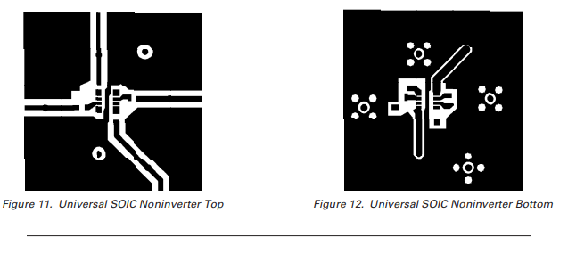

Layout recommendations -
above from datasheet
Eval board (note 6 layer) -

Schematic in post #1 shows no power supply? Both supply pins are capacitively coupled to ground?
I think that there is a small "+5VA" and a "-5VA" on the diagram.
It would make the diagram far easier to understand if the two op-amps were shown separately.
It's seems odd to use a really fast op-amp to buffer and invert a potentiometer. The fact that it is getting hot with no load, and the fact that 15 pF makes it hotter, makes it look like high-speed oscillation. If you get an op-amp with a much lower bandwidth, it's less likely to oscillate.
If the AD8017 does oscillate, you need a good oscilloscope to spot that it is oscillating.
The ground is continuous on top and bottom around the component and all those small vias you see are all stitching both ground planes
I am leaning towards oscillation too since it gets too hot with a cap in parallel to feedback in the second stage.
What would you guys recommend for a good VF dual op-amp that is unity gain stable and low offset and temperature drift? I know there are many to choose, but looking for one that would be a good choice
Notice the ground is not poured everywhere in the datasheet recommendations,
rather surrounds the part ? But looking at ap note on eval board one cannot tell
if plane is void below the part or poured on the inner layers......
From datasheet -
The PCB should have a ground plane covering all unused portions of the component side of the board to provide a low impedance ground path. The ground plane should be removed from the area near the input pins to reduce stray capacitance.
You have a few widely scattered VIAs and many "ends" of ground plane left open. The whole thing is a resonator.
Stitching means bonding at close regular intervals!
For now, I replaced it with AD712 and there is no heat issue at all. Then AD712 is not a CFB type.
But would like to investigate this issue and learn why it is happening though. I have another board of the same type with same behavior
