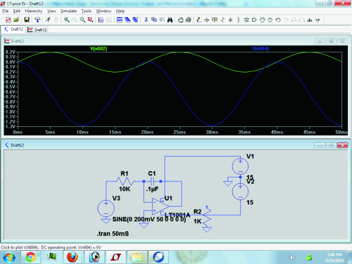

I am using sin wave and the output is -cos wave as we have formula of it sin x dx = -cos x + C
what does C mean here?
and changing value of R and C what will happen is there any formula of it?

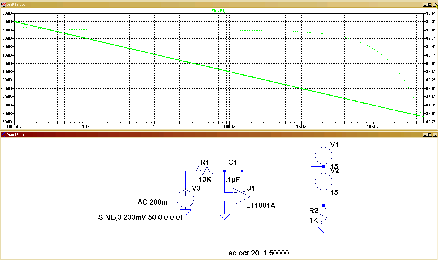

Does the op amp is negative feed back with capacitor?
how to drawn this gain graph?

Integration and differentiation are not the same thing. In post #5, your equation is for differentiation but your schematic is an integrator. This makes it very difficult to provide an answer. If you do not understand the basics of calculus, and basic opamp gain equations, then opamp circuits to implement calculus equations will not make sense.

This is the SIM from your asc LTS image
The plot shows the frequency response you requested.

and 0dB mean there is no loss what does -ve mean here?
so, what we get from this frequency response?

SIM is this context is a LTSpice simulation of your circuit diagram.
-ve is the negative supply voltage supply to the amplifier. [ where is -ve on the diagrams???]

I am working with this equation the output is cos wave which is in negative region but what does this C mean?
whatwaht is the practical application of sin integrate to -cos?

where is c in output wave?
and what we get fromintegrating sin wave?
what is the application of it where we can see it?

C can be viewed as a DC level that can exist on the integrator output at the start of the integration time.
If you integrate a sine wave, you get a cosine wave.
