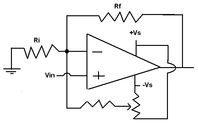

Thanks for reply, I am little confused with all the wording. Does the diagram below match your suggestion ? If so, can you please explain "resistor values" ( Rin and the resistor between pot and the non-inverting input)

Yes that is basically the idea, however full + and - voltages may to too course for nulling out small mv offset values. Smaller voltages or resistor voltage dividers driving the pot would give better resolution control for the offset pot.
As far as values for the input resistors if you just do searches on summing op amps you should be able to find a source for the calculations needed depending on the input voltage range and the desired gain of the circuit.
Lefty
Adding a voltage to the non-inverting input affects the gain of the opamp because it is an attenuator.
The inverting input of an opamp is its summing input. Adding a positive or negative current with a pot for nulling won't affect its gain.

The current through the offset adjust pot plus in the series resistor is an input into the inverting input of the opamp. The ratio of the feedback resistor to these totaled resistances is the calculation for how much offset voltage is produced.

A voltage divider approach for powering the pot ends was just to try and explain problems if you tried to use the offset circuit as shown. A full + and - 12vdc say is way too much voltage for nulling out small offsets, you would most likely not be able to adjust the pot smoothly enough to actual adjust out any offset. The theory of using a summing junction to make a external offset null adjustment is valid, but in actual practice one would have to deal with practical problems (like voltage and temp drift and pot resolution) and design around them.

But the value of the resistor that injects the current is in the gain equation. Also, the pot setting will slightly affect the gain.
Hi Roff,
adding or subtracing a current to/from the inverting input of an opamp does not affect its voltage gain because the inverting input is a "virtual ground".
In an inverting amp, what you say is true.
In a noninverting amp,
EDIT: Oops! I had this equation wrong the first time.
Av = (Rf+Rs)/Rs
The current injection resistor is part of Rs. It is therefore in the gain equation. In addition, varying the pot causes the value of that resistor to change slightly.
EDIT: Here's another way of looking at it. The inverting input is not virtual ground, it is virtual input signal. Therefore, signal-related current through the current injection resistor (Ri) will be Vin/Ri.
