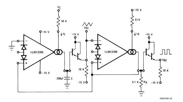

Today I had an idea. I wanted to have a Low frequency Oscillator with lm13700. Music From Outer Space has circuit diagram of one that has sinus wave output. But I know there are Voltage Controlled Low Frequency Oscillators with the same IC. The bottom diagram is voltage controlled but it lacks sinus output.
This circuit uses one of the LM13700's OTAs for LFO and another for Voltage Controlled Amplifier. But I don't want to have VCA for now so I did not build the right section of the circuit in the image and connected the triangle output of it to Music From Outer Space's LFO's triangle to sinus converter section that uses the second OTA. At the end I combined those two circuits to have a VCLFO that also has sine wave with square and triangle. My problem is that this thing doesn't want to oscillate. When I touch the pin 1 of LM13700 with my multimeter prop or tweezers I can see that a signal is created on sine output. And when I touch the other input of the lm13700 (trig out) there are similar signals being generated on sinus out accordingly. I can also see that these small voltage spikes are actually being distorted into a somewhat sinus wave with my oscillator. Triangle and square outputs also get spikes but no continuous waves are appearing. I checked and messed with pots and such and couldn't get it going.

Just a thought but build the essence of the oscillator on a breadboard first,
just the main loop, and get that working. To produce a clean tri wave.
From the datasheet replace the second amp with your comparator solution, get that working.
Regards, Dana.

It is showing the same exact behaviour. It is stuck at +3.04V (exactly same number) and some waves appear if I touch stuff but no oscillation.

Ok my bad got it going now. This confirms that there is something wrong within a specific part of the circuit at least.

At its most basic level, as an amp, can you show your 13700 is not bad ?
I have built that basic osc in datasheet 30+ years ago, it worked.
Your capacitor is not mismarked and actually in the pF range....?
Regards, Dana.
danadak Looking at the breadboard made me realise the mistake and I fixed it. Non inverting out of LM13700 was connected to output of tl074 instead of non inverting input. Chinese lm13700 I got for 1/5 of local price are working.
