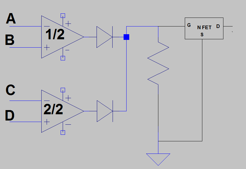

FYI - Here's how & what I'm doing in regards to this question.

This will cause the opamp with the higher voltage to control the gate of the NFET. The gate will be one diode drop below the opamp output voltage. I would use Ge or Schottky diodes.
Your diodes make an OR gate.
When one OR both opamp outputs go high then the Mosfet turns on if its gate voltage is high enough.
The outputs of the opamps do not fight.
