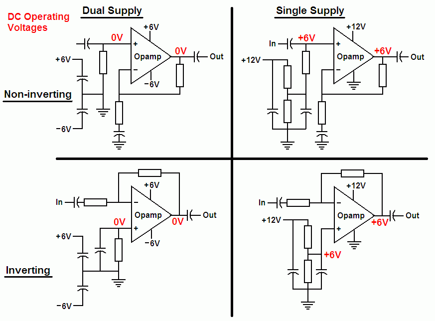

How do I power my opamps with only a 24V dc supply
Hi I have built plenty of circuits in school but I always had a +/- 15V supply. Now that I want to build circuits at home I do not have a supply that goes negative (I do have a 24V DC supply) Can I use it to power an OPAMP that wants +/-15V? by giving it +24 Vcc and 0V Vee or must I come up with a -12V supply. How can I get the -12V from my current supply?
any advise will be appreciated
Opamps don't need a positive and a negative supply. They just need to have their input voltages set to within the power supply voltages. A single power supply voltage can be used if the input, output and feedback divider resistor are capacitive-coupled like this:
