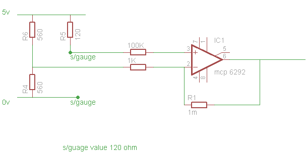

Trying to increase vout from 0v? to close to rail voltage but dont know what i am doing.
The op amp is a microchip mcp 6292 rail to rail amp I am using to measure strain gauge in bridge circuit it is working but not right. Dont know if correct resistor config or values please see attached schematic thanks

A bridge circuit has four resistors. Yours only has three (R4, R5, R6). To learn more about what you are doing, try reading some tutorials on bridge circuits and bridge amplifiers (just Google). You obviously need more understanding.

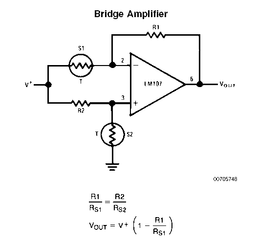

You need to configure the circuit like this bridge circuit with amp:

How can we tell you what gain is needed to get voltage near the rail if you don't tell us what the change in the strain gauge resistance is and what the amp operating voltages are? We're not psychic.
The strain gauge is the fourth res The amp is operating on the same voltage as the bridge
circuit .The strain gauge resistance is very small i will measure it again after work .sorry for not enough info

Did you use a symbol for a different op amp? That is not the pinout of an MCP6292.
The strain gauge resistance is (120.3 ohms no load)(120.5 full load) so not much change i have got it working better by changing a few resistors got rid of r2 and put 220k in parallel with r7 and 10k in parallel with s/gauge .The vout goes from about 4.9v to .5v .Imagine what i could do if i knew what i was doing

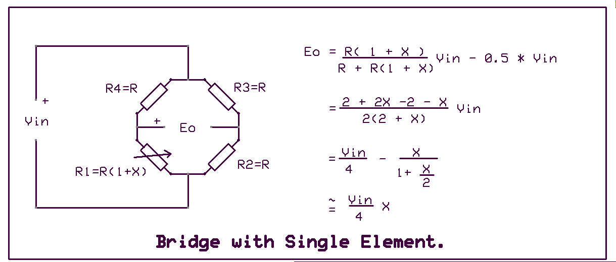

If you considered two 100R 1% in series and say the the top resistor was 1% high on 100R and the lower resistor was 1% low on 100R.
For explanation, assume the two resistor are connected across a 10Vdc supply.
What do you calculate the voltage at the junction of the two resistors to be when measured with respect to 0V.???:)

That is a voltage divider so 5 volts
bee
Remember you are working at millivolt levels.
So if the top resistor was 101R and the bottom resistor is 99R [ total 200R]
Connected across 10V, gives a current of 0.05A.
Using ohms law on the lower resistor of 99R, gives a voltage drop of 4.95V, so you have a ZERO error voltage of 50mV.!!!!
As your amp has a gain say of 1000. then the Vout would be 50V.!!!
You should always consider a method for ZEROing the bridge offset , BEFORE the amp.
I have added an image of a single element bridge that may help your calculations.:)

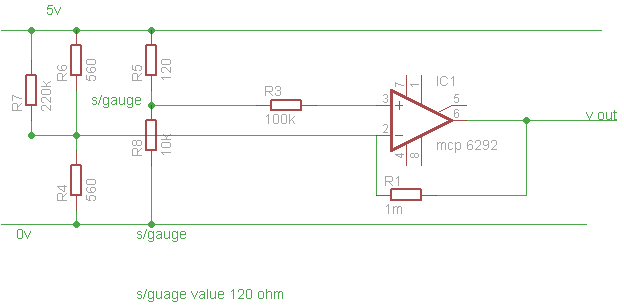

Sorry slow to post got called to work. What method of zeroing the offset can i use on this circuit .Also is this cicuit correct,and the voltage starts at 4.9v and goes down to .5v when load applied will change schematic and repost tomorrow thanks

schematic update
This is the updated schematic for your perusal(big word) note that is not the correct pinout for 6292 it is all i could find in eagle.Thanks for taking the time to help me with this much appreciated.

Note sure I understand the "GF 2.07 +- 1%" part? If it means that 2.07 grams (or grains?) of force equals 120 ohms +/- .1 then that is a single reference point and doesn't state what the resistance should be with 0 grams (or grains) of force. There needs to be known the slope of the gauge and that takes at least two points to categorize. Again a full spec sheet is what's required. I suggest that designing the op amp's gain and balancing requirements is premature without full knowledge of the sensors sensitivity and range specifications.
