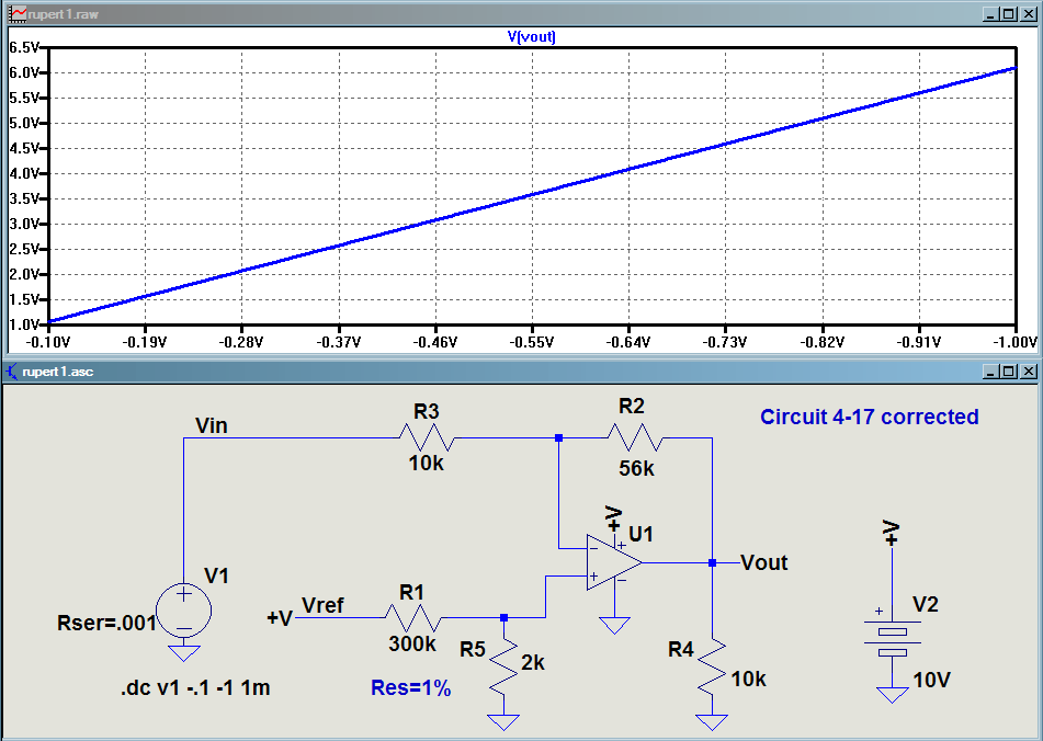

hi rupert,
This is a LTspice sim of the example circuit.
In the original circuit, R1 and R2 are crossed over.
IMHO, as there are so many errors in this section of the datasheet, its totally useless as a teaching guide.

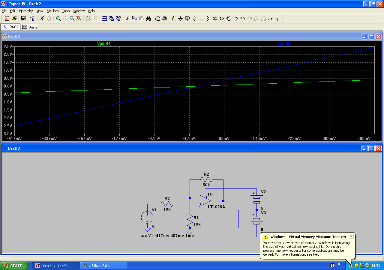

What can I say - THANK YOU SO MUCH!!!
I have have a good read this morning and based on the pH probe question of the forum came up with this - it may not be the best in the world but it's the first one I have ever got correct (maybe)!:D
Rupert

It looks OK at first glance, please post your *.asc file for LTspice.;)
