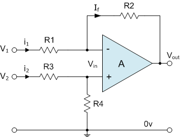

I have made a difference amplifier (subtractor) based upon OP-AMPs as below pic.
The whole 4 resistors which I used were 10K. I have just a problem by it. When I connect a sine input to the V1 the said sine wave just drops in volatge by say a factor of 2!! But when I connect the said sine signal to the V2, The signal does not drops at all!
By the way When I increasing the feedback resistor to a higher one the signal at V1 is less dropped!?
What is the problem please and how to solve it?
I myself guess that the input impedances at V1 and V2 are not the same, even by using the same resistors for them though It is very strange and should not be correct!? But I am not sure?!

Are you sure you've got that the right way round? If your circuit is wired as shown the sine input to V2 will be halved by R3 and R4 acting as a potential divider, so only half will reach the non-inverting input of the amplifier.
With the sine input at V1 the amplifier gain is -1, i.e. the output is the same magnitude as the input sine but is inverted.
Increasing the feedback resistor increases the amplifier gain so will increase the output voltage.
The circuit is correct. It just requires a low (ideally zero) source impedance for both inputs. Thus when you input the voltage to V2, V1 must also be connected to a low impedance source (ground if you don't have a source connected). Otherwise the non-inverting gain from V2 is 1/2 as you observed, not 1 as it should be.
If you calculate the gains you will see that, for the proper connections, you have an inverting gain of 1 from the V1 input and a non-inverting gain of 1 from the V2 input, thus it acts like a differential amplifier with a gain of one.

I think the Pic shows the right circuitry. I guess the reason of using a resistor divider in V2 is the gain of a non inverting op-amp which is 2 if R1 and R2 happen to have similar values.
Sorry But If I got it right, You are saying that the output gain from noninverting input while the Ri and Rf are simillar is just 1/2,right??!! I think it is 2 not 1/2 and thats why a subtractor has resitive divider at noninverting input (to reduce the incommong volatge to 1/2). Am I right?
,In a subtractor whole resistors are simillar, so If you calculate the gains you will see that, for the proper connections, you have an inverting gain of 1 from the V1 input and a non-inverting gain of 1 from the V2 input, thus it acts like a differential amplifier with a gain of one.
Sorry as I said I think the gain for the non inverting input should be 2 (1+Rf/Ri), What the volatge divider at noninverting input will cause to have an propper output.

Since the V1 input has a gain of minus 1 and the V2 input has a gain of plus 1 the output for the first case will be
-(Vmsinwt) + (-Vmsinwt) = -2Vmsinwt.
Edit: For the second case with V1 = -Vmsinwt, the output will be
-(-Vmsinwt) + (-Vmsinwt) = 0
