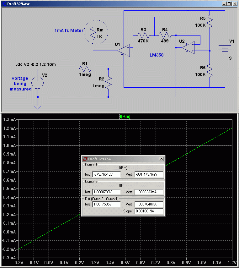

Hey,I'm wanting to build a multimeter with a 1mA meter,resistors and a lm324 opamp. I think it can source 5-10mA. I'm using the opamp as a voltage follower. I know I will not be able to measure mains power but I think for me a low voltage vom meter is good enough for me. I'm thinking about powering it from 2x 9v batteries, so it gives the opamp 18v so it has a wide range of voltage
Your 1mA meter needs about 100mV to show full scale, it means that the input to the op amp is also 100mV. You get this voltage by using 2 resistors voltage devider. It also means that you are OK with one 9V battery even when you measure up to 1000V.

Here is a circuit.
It produces 1mA in the meter if the input is 1V
It uses a second opamp as a rail splitter.
It has an input impedance of ~2megΩ
It has a modicum of protection in case you connect it to a high voltage
It can use a nothing-special opamp like a LM358
You can make R2 switchable to change the input scaling.
You can reduce R4 to 50Ω or 5Ω to make the input sensitivity 100mV or 10mV full-scale, respectively.

In any meter design it is also customary to use two back to back diodes to protect against over voltages of either polarity.
Since the voltage divider resistors are there already in most cases, the current to the diodes will already be limited, but if not a series resistor can always be added which will then limit the current to the diodes.
A 1k resistor at 1000 volts will draw 1 amp, so that's probably not good enough. A 10k resistor will draw 0.1 amps at 1000 volts, so that's probably better even if you dont intend to measure 1000 volts, but it would also be a lot of power in the resistor, but then again the voltage divider would have a higher resistor anyway. 100k at 1000 volts would draw 0.01 amps at a power of 10 watts, so that may be doable At 500 volts it's only 2.5 watts, and at 250 volts it's 0.625 watts.

Can I suggest a nice little addition, a 1n4148 across the meter, with its anode to the meter +, this means no more more than around 6x the meters rated voltage will be across it, the op amp might blow up but the meter ought to survive a mishap.
The lm358 and the lm324 are very similar, the former being a dual op amp, if you want current ranges too you could use the spare ones in a lm324 for that.
