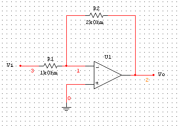

o, do anyone tell me how to use LM741 as a voltage amplifer?? how to set the voltage gain???

In the draw i attached i made a Voltage multiplier, it takes the voltage of Vi and multiply it in R2/R1 and invert it.
so Vo= - (Vi*R2/R10)
Remember that Vo cannot pass you VCC !!

o, thanks!! :)

also, for the Op Amp LM741, I was fail to ues it as a voltage amplifier.... the output voltage is less then the input one.......I don't know what i did wrong... :cry:
