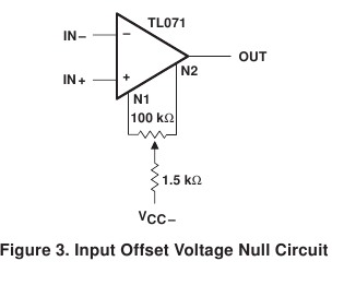

The point is another one, and I think I haven't made it clear because of the title. I want to know if leaving OUT the resistor will do any (and what kinds of) harm to the circuit. What's the influence of this "uncompensated" input bias current? Will it leave some DC level on the input of the amp, will it be solved with the normal compensation terminals that some op-amps have (like pins 1 & 5 of the TL071)?

the bias nulling terminals on the TL071 are linked to the current mirror, and are used as in the picture below.
