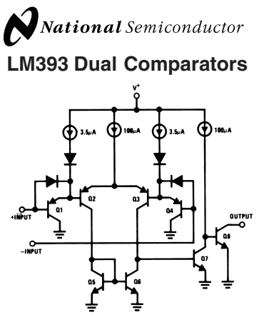

i was looking at datasheet of old opamp (lm393) and saw circuit scheme of opamp inside. Then i wonder it how things working inside. But i didnt clearly understand structure of opamp. Searched on internet and didnt found what i was looking for , or i couldnt searched correctly.
I m looking for text or a video to explaine how its works. For example on comparison operation , how its work. Which transistor getting switch and which is not etc.
Do you know any pages or videos to explain step by step ?
EDIT: ıt doesnt need to be lm393's inside. Every opamp will be good for me.

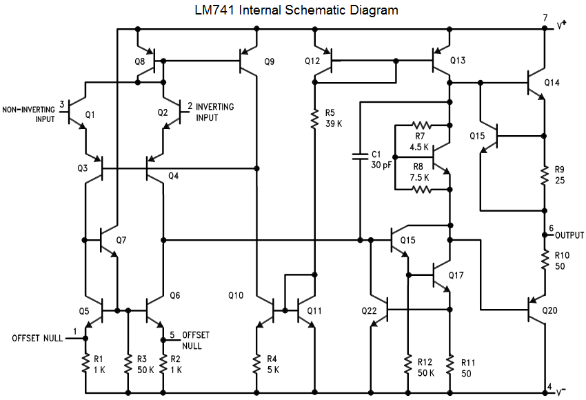

The best way to learn is download the internals of the old 741...
There are a few members here that could identify the constant current sources, the constant current sink circuits, the over current circuit and the buffer... But the basic differential circuit is on the input..
There are quite a few transistors used as current sources & current mirrors in the 741, which may make it difficult to follow.

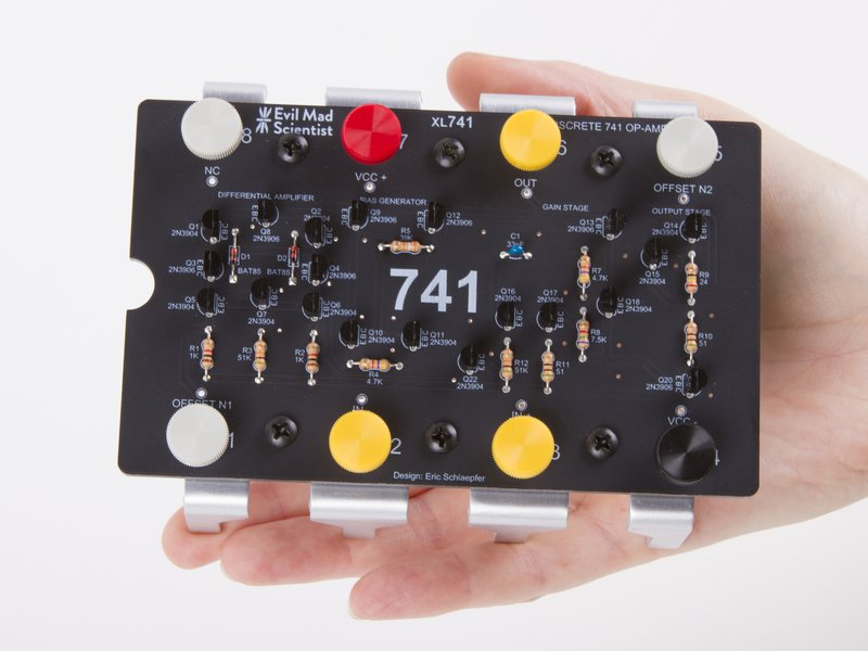

This is one that can be built with conventional components and is a bit easier to understand:
One of the important things when attempting to understand analog ICs, is that the integrated nature and the intimate relationships of the IC's integrated components, allow for circuit tricks which otherwise are very difficult or almost impossible to obtain with discrete components.
One simple example: the differential amp Q1 and Q2. Unless precisely selected and characterized devices are employed, plus some additional trimmings, the resulting voltage offset would be really bad.......especially across the full temperature range.
Nevertheless, prior to affordable IC technology, companies would indeed build discrete semiconductor opamps...... heck, they even built vacuum tube opamps, the most famous was the Philbrick Researches K2-W, as it was one of the first "low cost" general purpose opamps.
An LM393 is not an opamp, instead it is a dual comparator. Look at its datasheet. Its circuit is very simple.
To see how it works, learn about transistors, opamps and comparators.

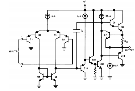

Below is the schematic for the LM324 opamp, which is also fairly simple.
The main difference between the opamp and the comparator is the opamp compensation capacitor Cc.
This forms the frequency response such that the opamp is stable for typical closed-loop negative feedback circuits.
To simplify the schematic, the transistor current-mirrors are shown as current sources (which is their function).
Here's the basic operation:
Q1 through Q4 form the differential input stage (it uses a Darlington configuration to minimize input bias currents).
Q8 and Q9 form a current-mirror that converts the differential stage voltage to single-ended, which is then be amplified and level-shifted by the rest of the circuitry to generate the Output signal.
Most op amps follow this basic configuration.
