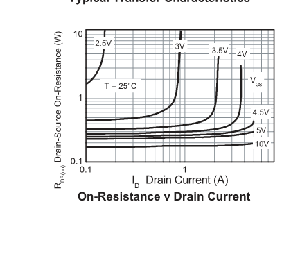

Can you confirm what you mean by OL, do you mean Output Low, if yes the mosfet is saturated.????
Yeah I meant 0 logic.
What is the advantage of being saturated over linear state?
If I recall right, rds in saturation region is smaller than rds in linear region, is it becaues of that?
hi alpha.
May I ask, is this homework.?:)

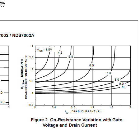

The advantage is that in saturation the dissipation within the device should be at a minimum.
Rds is an inverse function of Vgs and Ids.
hi,:)
Look at this graph, the datasheets for MOSFET's give lots of info.
EDIT: another type.

Hey Eric.
Its not homework, I start my third year in EE only in November 09.
What is the reason that the dissipation within the device in saturation is at minumum?
isnt it becuase rds in saturation is at minumum, and therefore for a given IDS current, the double I^2/rds will be at minumum?
Hey Eric.
Basically yes, look at the edit image in last post.
Alright, I understood these pictures, I think, and my mistakes also.
In saturation region, rds is infinite, since the tunnel is pinched off, not allowing more electrons to pass in a certain time interval.
The current can still increase with increasing VDS, since the tunnel gets shorter.
Therefore in the graphs you see that there is a point where rds gets infinite, and this is the point where the MOSFET enters saturation region.
I hope I'm correct.
I cant thank you enough for your great patient you've shown. :)
Lots of thanks!!! next time you should explain to me what the movie Traffic is about, I didnt understand its purpose at all when saw it yesterday. :)
