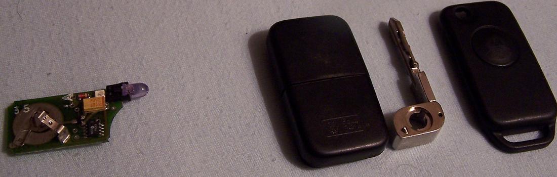

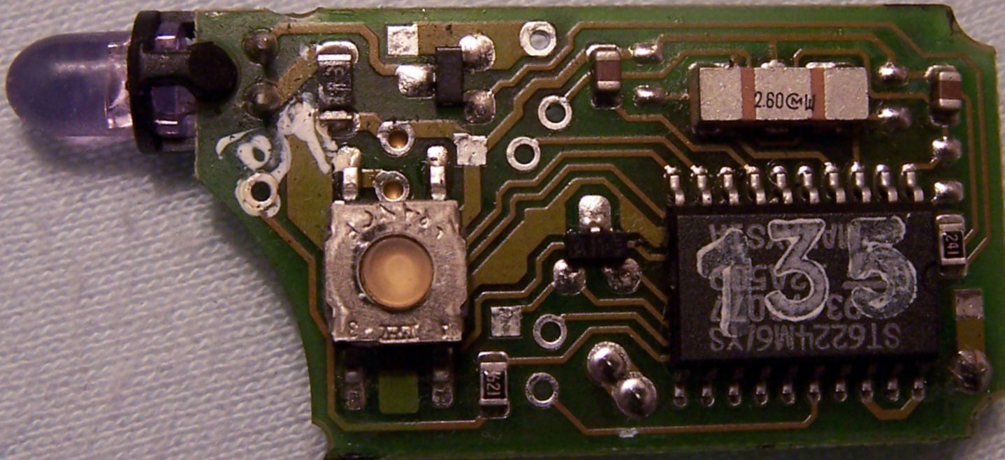

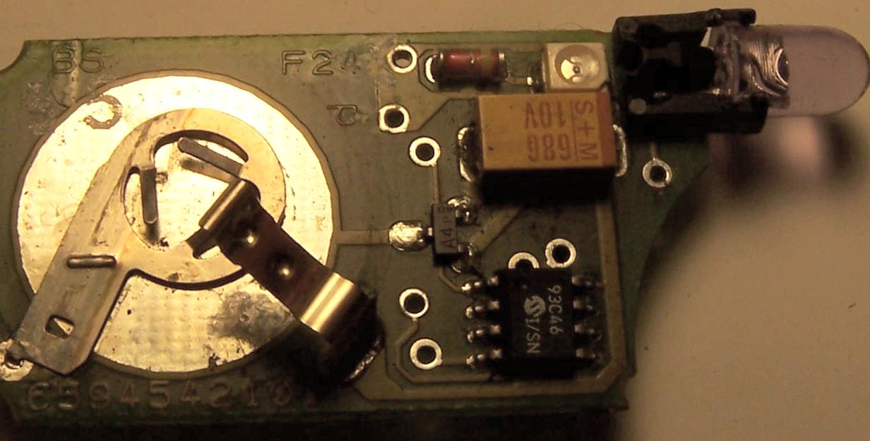

Maybe you can help me if I post the Pictures
THX Oznog
Very interesting.
I just opened my key - it is not as complicated as it seems
I will post a detailed photo and also the numbers which are on the device.
Here is the key - can you tell anything from that ?

I would guess that it uses rolling codes, like garage door openers do, and modulates an IR LED with that code. Changing IR wavelengths would require a different LED for each wavelength, unless someone has come up with a tuneable LED - which I seriously doubt.

I cant read the number off of the big circuit, but the small one is a serial eeprom, which may contain the code or whatever for the car. When the person referred to the frequency, I dont think they meant the freq of the light, but rather the frequency of the pulsing. Having said that, my thought is that the frequency of the carrier is fixed and the bit pattern changes each time it is pressed, using some kind of rolling code technology.
