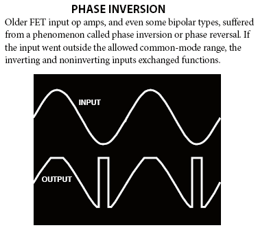

The TL07x and TL08x opamps have Jfet inputs. They have a problem called "phase inversion" where the output suddenly goes high if an input voltage gets within a few volts from the negative supply voltage.
