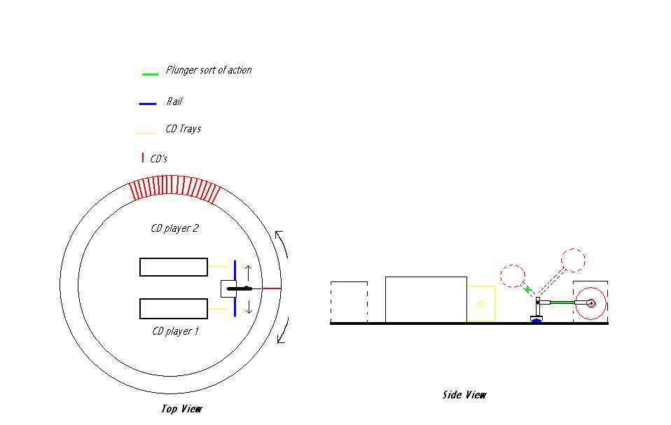

Sounds like a great idea grrr but I reckon it would be much easier to use a turntable instead of a rack.That way the turntable can rotate and your robotic arm can stay in one place.Maybe you could have the layout so that your CD players and arm are in the midle of the turntable 8)
Check out the diagram below! :D
that would make it a lot easier. And i like the diagram.
Again though, i'm attracted to the challenge of my method. Trying to do something in the hardest possible way...
It'll be a while til i get round to it, so i'll have plenty of time to get round to the sensible way of doing things.
Thanks for ALL the suggestions, I really appreciated them.
