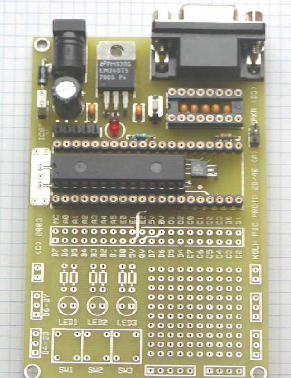

maybe this isn't much help, but I was in the same position as you seem to be in about 2 years ago. I had to teach PICs to an electronics class in the near future and needed some eqipment to get them to use. A colleague later asked for some advice in doing the same, so I set up a website to help. It's **broken link removed**if you want to visit it.
I designed and purchased 3 prototype boards for $59 from ExpressPCB when getting started several years ago, which worked out quite well.

I guess if you use sockets you can stick stuff underneath the ICs. I tend to prefer to stick a ground plane beneat them though...but then no sockets. Not much of a choice though if you use SMD. I always thought it was bad practice to route stuff underneath an IC so I've never tried it. Does anything wrong ever happen because of that?
What is that metal plate for around the power inputs of the PIC?
Those pin strips are really nice for that. If you actually need a ground plane for an analog design under it you can always mount a foil sheet under it. They're also breakaway so you can make dip basings for any size using a single generic cheap part you buy in bulk. Mike, where'd you get those from? I don't feel like hunting through my Digikey catalog to find what they are, don't need em now but it's such a 'smart part' for hobby usage I might throw some on my next order to beat the shipping limit.

If you're talking about the single-inline machined pin sockets, you can get them almost anywhere. I've purchased 20 pin single-inline units from Mouser and I also still have a bunch of 10 pin units from a bag of 100 purchased from Jameco long ago (part # 102200).
I used them in that prototype design for the combination 28/40 pin PIC socket.
Are you talking about the ground plane for the crystal or resonator on the left hand side of the PIC socket(s)?
Oh is that what that is? I didnt see a crystal. I didn't know you could use ground planes for crystals. I kept the area around there clear for me because it's digital and I didnt want parasitics. Maybe Im wrong.
