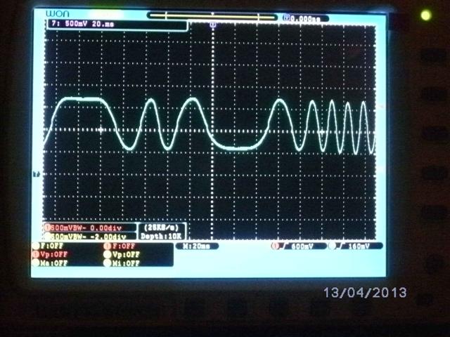

Optical rotary encoders as in PC's mice to be read through two PIC's pins.
Schmitt triggers in between, are they convenient? Or a must? Or not necessary at all?
In my experience the schmitt is a must.
Otherwise the slow rise time of the signal while the photo-interupter passes through the light beam, combined with a bit of noise on the signal, can cause all sorts of problems.

I go with JimB on this one, I have always found most optical encoders have slow rise times, use a Schmitt.
A software solution sounds attractive, but long debounce delays are required to ensure they covered the worst case encoders.

Sensor output
This is what the ST will have to deal with: output of one of the sensors obtained while turning de encoder's disk slowly back and forth.

What I would have expected.
As I said, Schmidt it.
