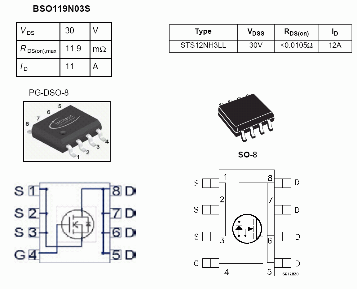

I had one of these things blow on my old video card, and it now gives no video (by blow I mean there is now a hole in the physical chip). This was caused when my power supply's capacitor ruptured, taking the motherboard with it too. I need a new one. Ive found them via distributors, but I have no access to credit cards or cheques, and I badly need one. Part number is BSO119N03S , marking on the chip is 119N3S. Anyone have one or can get one? I can pay via paypal. Thanks!

Notice in the chip on the left that the diode isnt connected to the < , and in the one on the right, they are conneced. Since its an expensive video card, I wouldnt even trust a difference like that. Also, mouser only takes credit cards, and as stated above, "I have no access to credit cards or cheques". Thanks for trying though.
Not sure what you mean there - they are both N-Channel MOSFETs in an SO-8 package with standard pinout. The body diode is part of the MOSFET itself and is always connected anode-to-source/cathode-to-drain.
