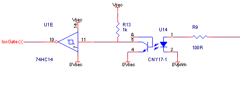

I have a gatedrive circuit that is going to production, It is using opto-siolation atm (6n137).
This isnt an "approved" componet. The approved comonent for products are the
CNY17-#x series.
These are 6pin devices.
one one side two are for the LED and on the other the three are the photo-diode.
No I shall be tying hte Emitter to the isolated GND and the collect (to my input) to +5V via a load resistor.
What do I do with the base connection? If I tie it low - Transistor will always be off, if I tie it high, transistor will be always on (or blow).
Do I leave it floating or Bias it?
I am using it as a ON-OFF signal, driving the LED with 30mA so will not be using it as a linear isolator

I wouldnt leave it floating.. I'm a little confused about what you are doing. Can you post a schematic? Tying the base through a series resistor might be what you need.
Just want an isolated signal.
Never used a Opto like this before, wanted a bit of advice

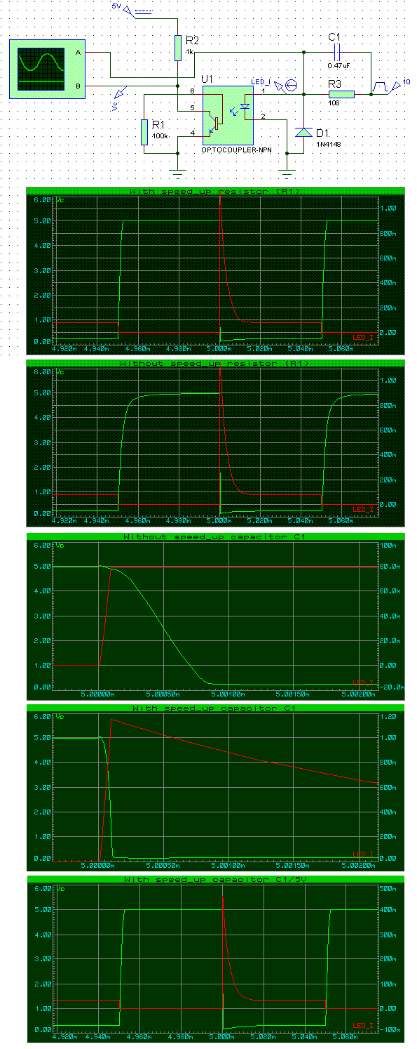

I have used a very similar setup before with drives. I will put a high value resistor 100K or so between b-e of the opto transistor, otherwise it will be slow at turn-off. Also add a cap over the series resistor to the led to get a nice high initial current. Also make sure in the data of the opto the collector resistor values (Ic) recommended for fastest switching speeds.
The default pulse input is at 10kHz/10Vp-p. Led current will be at 30mA for steady state using 5V pulse input, last graph. C1 will be calculated according to the pulse current spec of the LED
