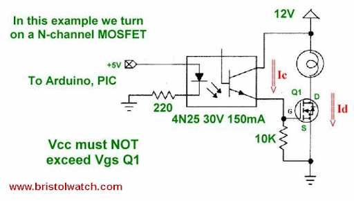

Greetings gentlemen,
i need an advise with optocoupler connection. I need to switch the negative side of the battery and arduino GND. If i connect it like on the picture attached i get like 40k - 2m ohm resistance on the output so it makes drop voltage to the half. Voltage measurement is the reason i am doing this so drop voltage is very undesirable. Is there a rule the collector must be more positive than the emitter or what am i doing wrong and how to fix it? The link for optocoupler datasheet is below. Battery voltage is 4V.

Normal optocouplers are not rated to pass high currents, they are more for signalling than power control.
You also have to allow for the "current transfer ratio" of the device you use - eg. the TLP621 has a CTR of typically 50% so the output transistor will only turn fully on if the current through it is somewhat less than half the current through the LED.
You really need a DC solid state relay type for power control, or use the opto to switch the gate or base drive to a separate transistor.
eg. something like this (but using a "logic level" FET as you are switching a low voltage:
Or this, with a bipolar transistor - put you load where the relay coil is shown:
Or something like this, which will switch 200mA with a 3mA control signal:

Voltage measuring is just signal isnt it? But dont know how much current flows in the curcuit. I tried to add resistance to the curcuit to get 9mA which is maximum transfer ratio for TLP621 ... i measured 60kohm on the output anyway.
Also .. what is the load.. the arduino? if i connect negative side of a battery to GND of an arduino? Arduino has its own external power supply.
That ASSR seems interesting .. what is the actual difference between optocoupler and assr?

It appears from the circuit that you originally posted, that you are trying to switch the power supply (or battery) that runs an Arduino module?
As Mike says, what exactly are you trying to switch??
The "load" is whatever the switch item is passing power for; it could be just a tiny current through a resistor for a logic signal, or controlling full power for something.
Sorry guys, my bad. I should have explained my curcuit first. I attached my schematic below. It is DIY balancer module for 4S battery. This is just for 2S. This cuircuit should measure the voltage of each cell (1 and 2) and in the case of exceeding over 4V, while charging, the mosfets (mos1,mos2) should turn on and the additional energy put into the power resistors (paralel rez1, rez2). When all cells are 4V the charging is interrupted. Accurate measurement is required for realization this project ... the accuracy of 0.01 atleast. As you probably know the arduinos maximum voltage is 5V so i can measure first cell and need a voltage divider to measure the others (8,12,16V). I tried to measure accuretly with voltage dividers but it is not easy to optimize the software for this .. dont even know if it is possible. So i decided to try different approach. Positive sides of all cells are constantly connected to the arduino (analog inputs) and only one cell´s negative side is connected at the time so GNDs of all cells are not shared (you know, what would happen). So arduino would send a signal to optocoupler to connect GND arduino with negative side of first cell, analog pin would measure the voltage and hold that value, after like 0,2s would disconnect GND of first cell and connects negative side of the second cell, analog pin would measure the voltage, hold the value etc etc. The values should update every second so circa 0,2s for each cell with time reserve. All values are gonna be shown on display. The connecting path resistance between negative cell side and arduino GND should be as low as possible to eliminate drop voltage.

It looks like you really need an analog switch to do it that method; a bipolar transistor is not ideal.
Also note that you cannot safely force the analog inputs on an MCU outside of the supply range limits. With that configuration, if you ground the negative of the lowest cell in a four cell pack, the ADC pins will have roughly 4, 8, 12 & 16V on them...
Personally, I'd use a differential amp to measure each cell voltage and adapt it to ground referenced.
eg. https://en.wikipedia.org/wiki/Differential_amplifier#Operational_amplifier_as_differential_amplifier
R1=R2; RF=RG. As long as the ratio of input to feedback resistors keeps the op amp inputs within common mode range, the circuit inputs can be far beyond the supply.
For an optically isolated analog switch type device, look at the H11F1 or similar.

The H11F1 is an optocoupler, but the output device is a special FET rather than a bipolar transistor.
In effect, it becomes a low-value resistor when on, that can conduct both ways and is also not polarity sensitive when off.
A bipolar transistor only conducts in one direction when on and requires a fixed polarity, so is not good for passing varying voltages, as you need.
