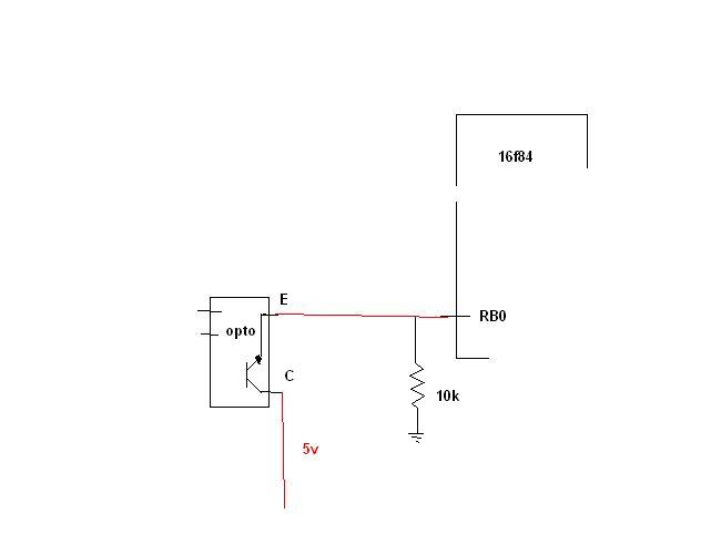

Ric this is what i have in mind. so far the optos ive tested did not yet work

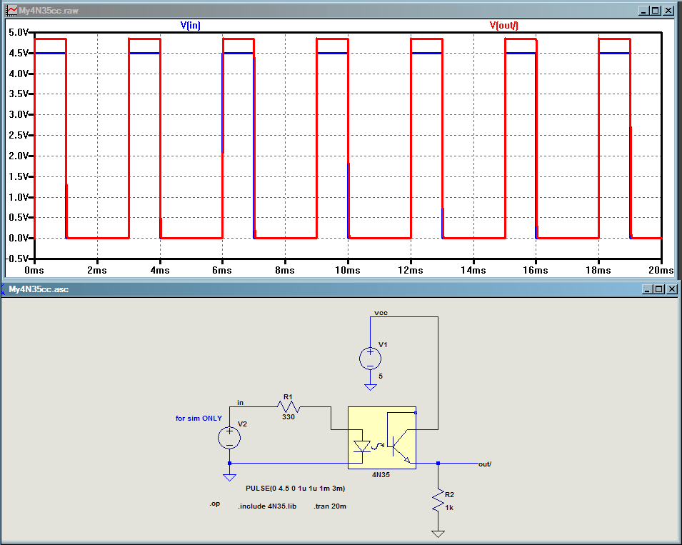

Is this what you are asking, positive pulse to the opto and a positive going pulse from the output of the transistor.?
i think no but the trigger for the opto is a negative pulse and for output, a high to trigger the interrupt inside my pic

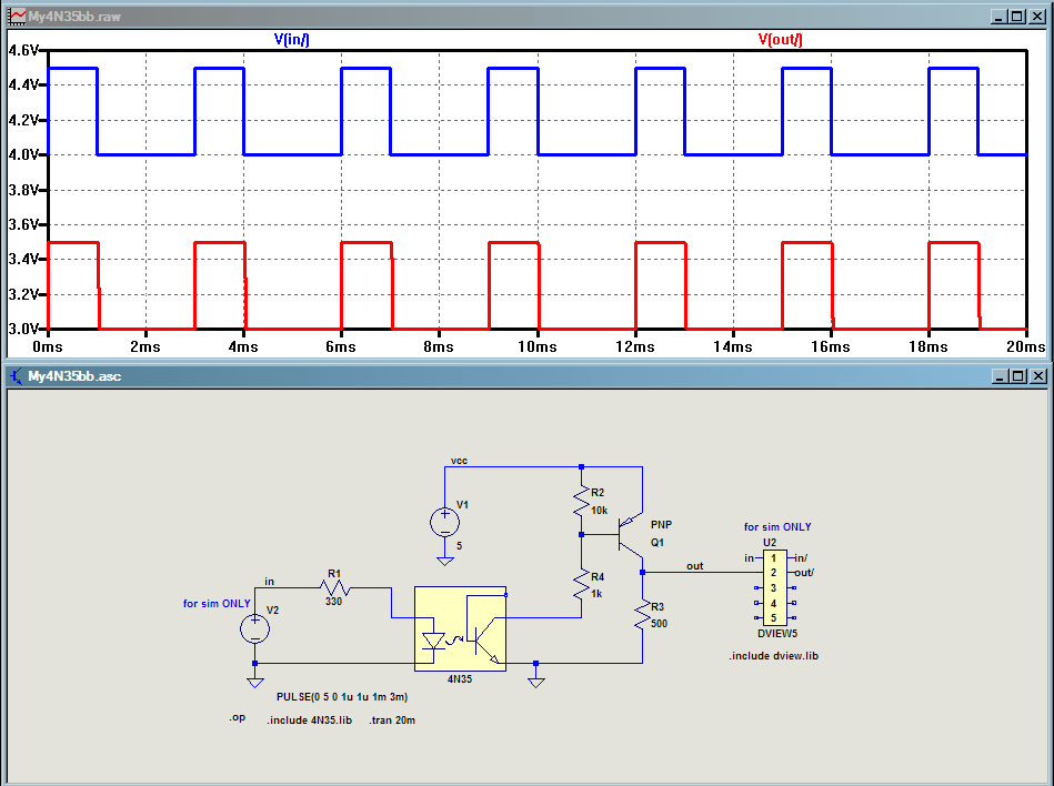

You could also do it this way.
Connect the collector of the opto's transistor to the +5 and the emitter to the PIC. Also you'll need a pull down resistor, see attached.
When you say 'a negative pulse' do you mean a pulse that goes from say 0 to -5V, or +5V to 0V
Just draw me the pulses you have in and out.:)
wow eric i think this is it!
thank you very much i'm heating up my solder ; )
thank you very much again. pnps are connected backwards
