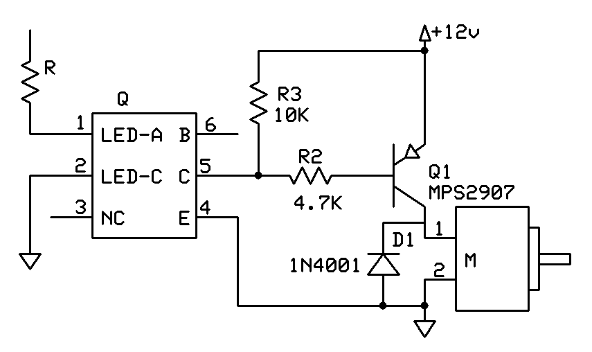

Now that that's out of the way, I need to hook up a dc motor to a sequencer. Its a simple situation- I just need to turn the thing on and off. No reverse directions or anything.
In the simulation I just use a logic gate connected to the led inputs of an optocoupler and it seems to be fine, but I'm afraid of the current in real life destroying the optocoupler. On the other side of the optocoupler I attach a 12V power supply to the collector (upper portion) and then the motor to the emitter (bottom) then to a resistor and then to ground and the negative side of the power supply.
I purchased two optocouplers, but neither seems to work. They may jsut be old and faulty, but now I'm unsure of myself. Does this circuit sound like it should work? The next step is buying brand new optocouplers from an internet source, and I don't wanna pay shipping only to find out my whole idea was dumb to begin with.

Optocouplers' output transistors cannot drive a motor. They are very low current devices. They could be used to drive a higher current bipolar junction transistor or MOSFET, that would drive the motor. What's the motor's current rating...or the resistance of the motor winding (assuming it is a 12VDC motor)?

The attached schematic should work...I think. Not sure if you have access to Radio Shack, but all the parts should be there. The diode is added to protect the Q1 form the motor spikes.

Wow, thanks. Any transistor would work there, or is the 1N4001 specific to this sort of issue? Also, if i just needed an electronic switch to activate a buzzer, an optocoupler is good for that, right? Also, waht is the purpose of the contained resistors? I really would like to udnerstand the circuit, not just implement it.
By "transistor" do you mean "diode" 1N4001...D1? Almost any diode would work...but I would suggest one in the with a voltage rating =/> 50V and a current rating of =/> 500mA.
Again it would dependent on how much current the buzzer requires. By the way, what opto-coupler are you using?
R2 pulls the base of the PNP transistor high (to +12V) to assure thar the transistor is "off" and not susceptible to noise when the opto's transistor is off. R3 limits base current to an acceptable value when the opto's transistor is "on" essentially shorting its collector to ground. Google for: transistor tutorial.

.....Stop right there!...an MOC3023 is a "triac" output coupler. It "will not work" on a DC circuit. It will only work on AC circuits. You need a different type of photocoupler.

A triac can be turned on with its terminals at either polarity, but won't turn off until its supply current is removed. With an AC supply this happens every half cycle...8.3 mSec. If you apply DC, once your LED in the coupler turns it on, it stays on.

Ok, so I've tested the circuit, and I think I understand how it works, but I have one issue. The motor does not stop when I "turn off" the transistor. A small voltage is leaking through. It's not enough to start the motor, but it's enough to keep it going. Also, the transistor I'm using (a BC640) gets incredibly hot. Is that going to be a problem?

I am using the schematic you posted. Same values. 10 k from emitter to optocoupler, and 4.7 k from base to optocoupler.
I have played around with it some, and only succeeded in ruining two transistors and a few optocouplers. So I came back to the original design, so far it being the only working one, and have the same overheating problem, as well as one I did not notice before- the motor runs without the optocoupler being activated. And I can't seem to figure out why. Any ideas? Thanks for your help thus far. It has been incredibly valuable.

If your motor draws 200mA, the base current to the transistor should be about 20mA.
With a 4.7K, you are driving the base with only about 2mA, the transistor will not saturate and will run hot.
