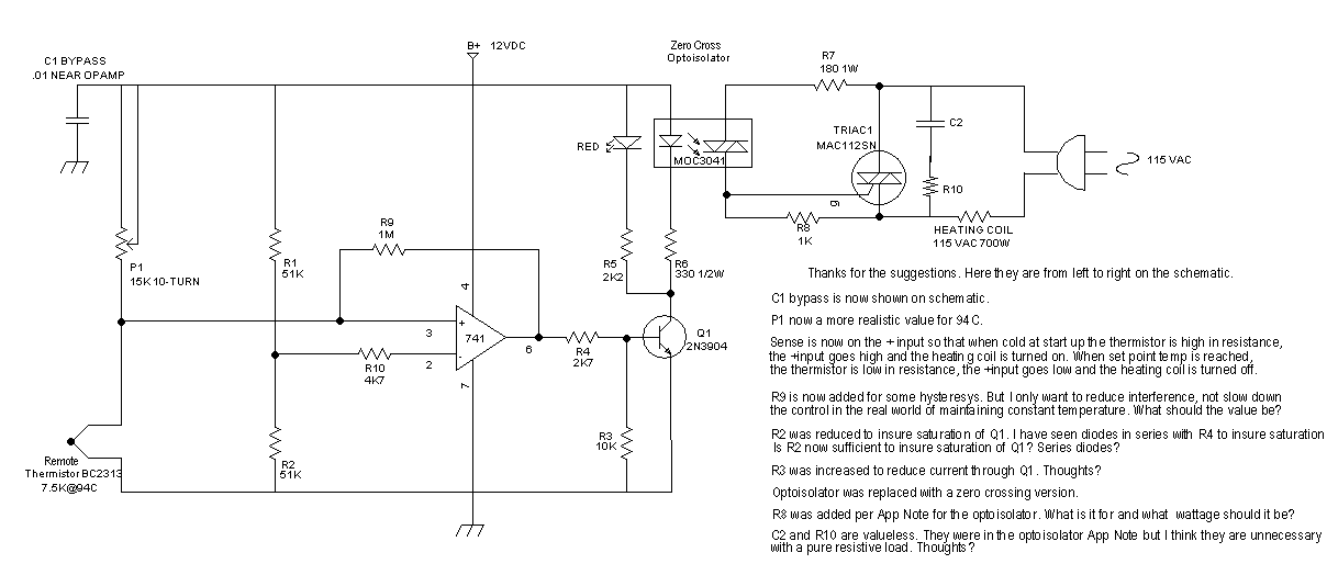

Hi All,
I got a few recommendations regarding the circuit I posted. So now I am back with a revised schematic and more questions.
Please take a look and tell us what you think. The questions are on the schematic.

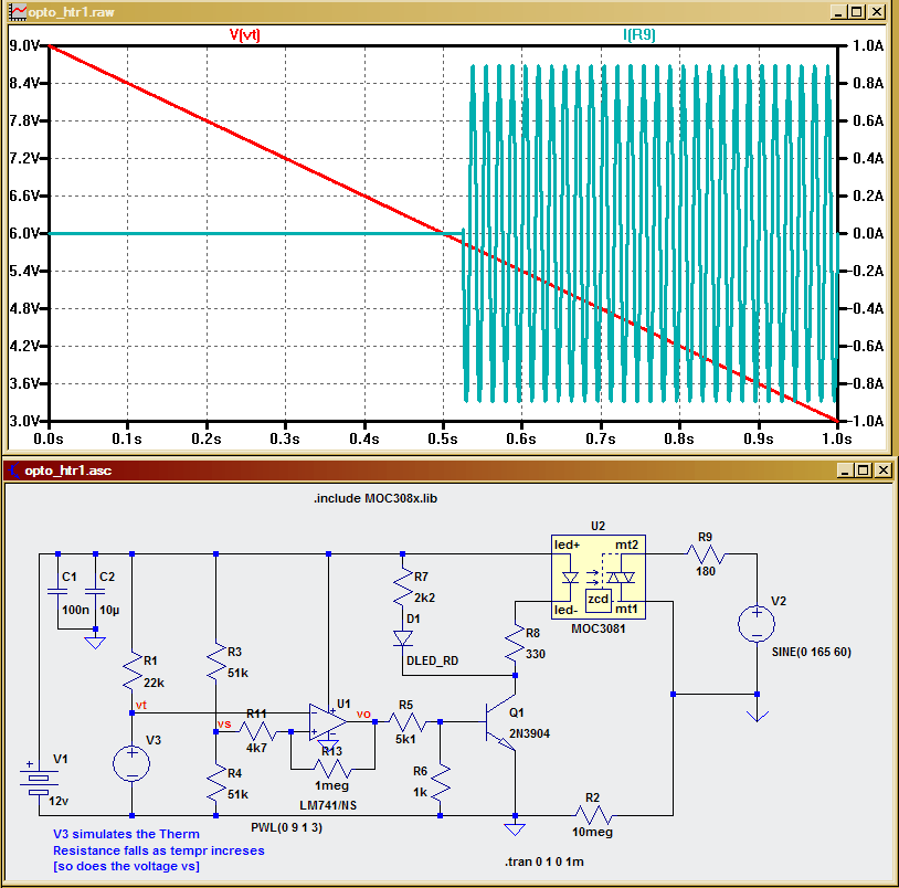

Do you know you have swapped over the Inv and NonInv inputs on the 2nd circuit.???
This will change the sense of the switching at the output.
EDIT:
As you can see from this image, the heater is switched ON as the water tempr rises.!
The Triac is not not shown only the ZC MOC.

Eric,
Thank you very much for the pointer.
Yes I previously did connect the sense signal to the wrong input. In the most recent schematic above the sense signal is attached to the +input rather than the -input like in your sim.
I changed that and added a couple other changes. All came from suggestions like yours.
I see that your circuit is not as changed as my most recent one. Is that a mild suggestion from you?

I use LTspice, its free, also the Yahoo Users group has lots of libraries of models.
If you decide on LTS, I could post your 'asc' file, its not easy at first to use LTS, but its a great tool that is well worth the time learning how to use it.
It will save you hours of maths.!

Those differences are just left overs from the previous.
EDIT:
You do realise with your last circuit the action is the wrong way around..

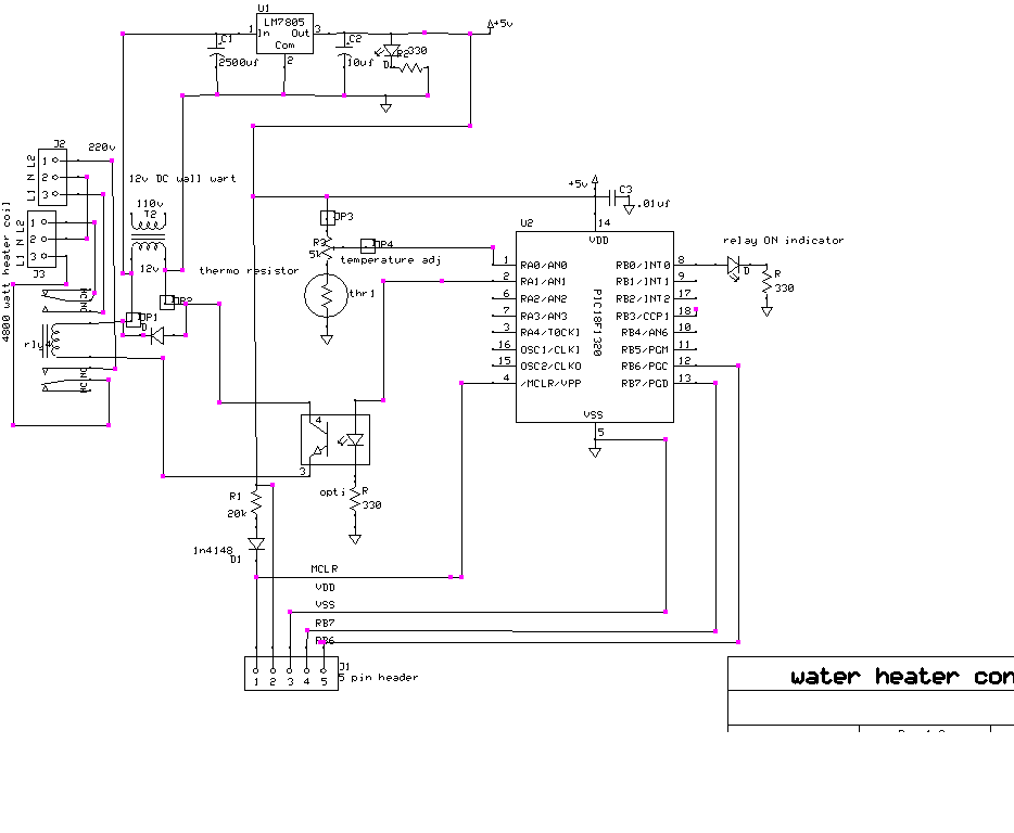

One thought?--is the water heater 110 or 220v
I have a similar design to implement but am going with a relay instead of a triac
reason = the water heater draws lots of current the one I am going to control has 2-20amp circuit breakers. When an inductance like a heater coil turns on its best to over design. It was suggested to add something like 130% to account for the turn on surge current.
I would be cautious about using a lone triac for this app. The triac will get warm if not hot.
here is my overkill schematic
basic design but going to downsize so just going to use a 741 op am instead of PIC
I just want to keep the water temperature at 60-70F degrees

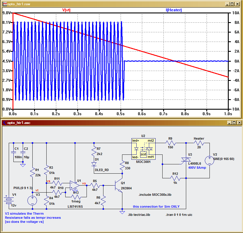

Look at this LTS image for the modified circuit, note the resistor changes on the 741 OPA output.
Attached is the 'asc' file, you will need to download the tectriac.lib and the MOX308x.lib, you can get these from the Yahoo LTspice users group, free, just sign up.
If you have a problem with LTS just ask, we will help out.
