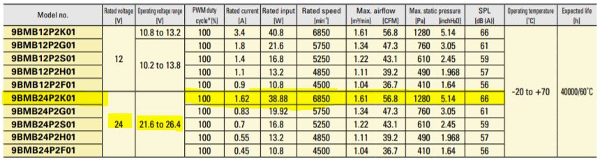

Hi all,
I ordered the fan (Sanyo Denki 9BMB24P2K01) and the power suplly (mean well RS 50-24).
Apparently, I need to regulate the outcoming voltage.
This is the datasheet of the fan:
If I'm correct, it should be 22,7? (50 w / 2,2 A = 22,7 V)
I'm all new to this, that's why I ask first before connecting these things.
Thank you all!
Hi all,
No, it's a 24V fan, you supply 24V to it - which isn't terribly critical, as shown in the specs.
