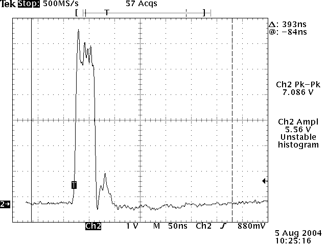

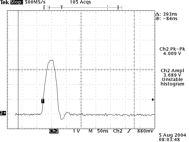

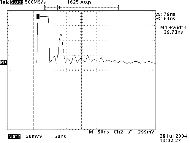

just one example of how a scope can be useful, we have some vicor dcdc converters that have a sync signal(PR pulse) to enable current sharing in parallel arrays. Problem was they would not start if the load was high & the input volts was low(within spec). Turns out the amplitude of the PR pulse was too high (thats what we were told) so the initial fix was to load the RX end of the transformer coupled signal to dampen things out a bit.
My point here is looking at a signal with an oscilloscope we can see what is going on.
examples below TX pin, RX pin before & after resistor addition.
