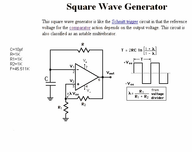

A comparator can be configured as a Schmitt trigger oscillator to produce a square wave.

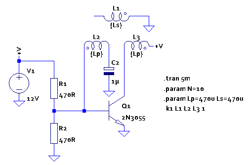

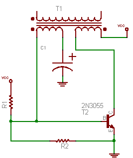

Here's a good oscillator that will run on 12 volts no problem.

That will work but how can you be sure or the frequency or the 50% duty cycle?
Well it has a good sinusoidal output so it depends on where you set the threshold.
edit*
One thing he could do is super-impose it on a DC level.
Well it has a good sinusoidal output.
No.
Maybe its output is a sine-wave at RF frequencies because the transistor is so slow. But at audio frequencies its output is a saturated square-wave because it has nothing to limit its max amplitude.

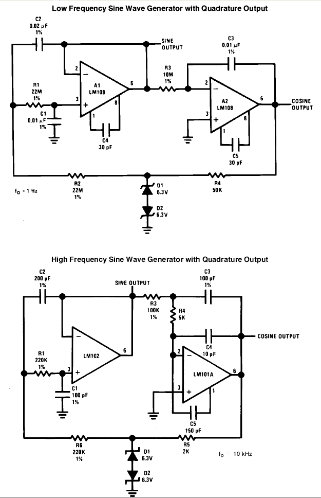

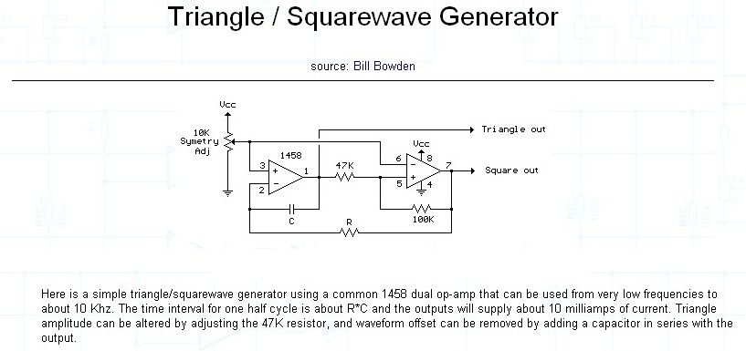

Very simple square wave generator adjust for 50% with voltage to pins 3&6 on the first one, ignore the voltage double half.
Here's some of the one I like, all copied off the Web
Kinarfi
The problem with phase shift is you have to adjust the value of more than one resistor.
Another option is to use a triangle wave generator and add a shaper circuit to get a sinewave generator which can be adjusted by varying the value of one pot.
When was the last time ypou made one? I have yet to see one saturate though it does have to do with the way you bias it. So I am sure you could make it happen. But really, it puts out a very pretty 50 / 50 cycle and the transistor I have in the example is better at audio and VLF. You could use any transistor. I was just giving the guy a somple oscillator circuit anyway. Seemed everybody just wanted to ask him a bunch of questions so I gave him something to work with.

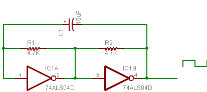

That's a good one. How about this very simple square wave oscillator:
The problem with it is the 12 volts but he could follow it up with an amplifier.
I don't make garbage circuits. I make a sine-wave oscillator with additional circuitry that stabilizes its output so it doesn't saturate which makes a square-wave.
Your simple circuit is a square-wave oscillator not a sine-wave oscillator.
I would love nothing more than to agree with you Audio. But it is a sine-wave a oscillator. It's an Armstrong oscillator and really it puts out a pretty sine wave. It's just not vary stable but it is powerful!

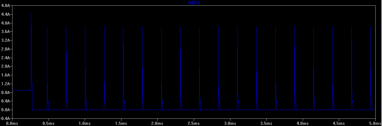

I've tried simulating it and it gives pules.
Simulators can be wrong of course, what values did you use? I guessed.
For some reason I couldn't attach the .asc file so here it is:

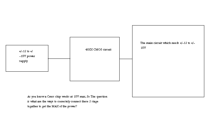

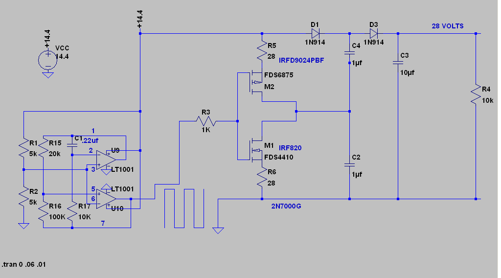

Thanks to all suggestions,
After reading your suggestions I came to this conclusion that working with CMOS chips as an Square wave producer circuitry (or those cmos multivibrator chips, Do you guys know any?) is the best choice because they are assembled easily and are really trustable.
So the Attached picture shows the main problem which I am dealing with.
I have serious problems to understand how to do so. My only guess is that maybe a capacitor between the single ended stage and the doubled stage is able to help to set the output signal of the cmos chip to zero, and thus gives a suitable signal for the last doubled stage? If so, Then what about the efficiency of this circuitry than a normal doubled circuit instead of 40XX?
Any paper to enlighten me about how to connect a single ended circuit to a doubled powered one, Pros and Cons, would be really aplicated.
You still really haven't provided enough information.
Do you want to switch the low/high side?
Do you need a pulse with at +/-12V?
Or do you need to switch an h-bridge?
