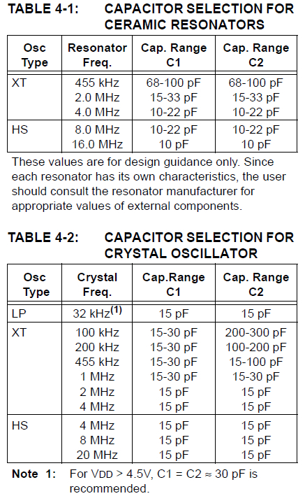

To connect any crystal to a pic i recommend follow the datasheet. in your case it starts on page 73.
Most important is page 78. I dont like that datasheet tho it doesnt show good enough information.
Here is a image of a part from the PIC16F54 Data sheet. It tells you recommended capacitance for the OSC. Hope it helps you.

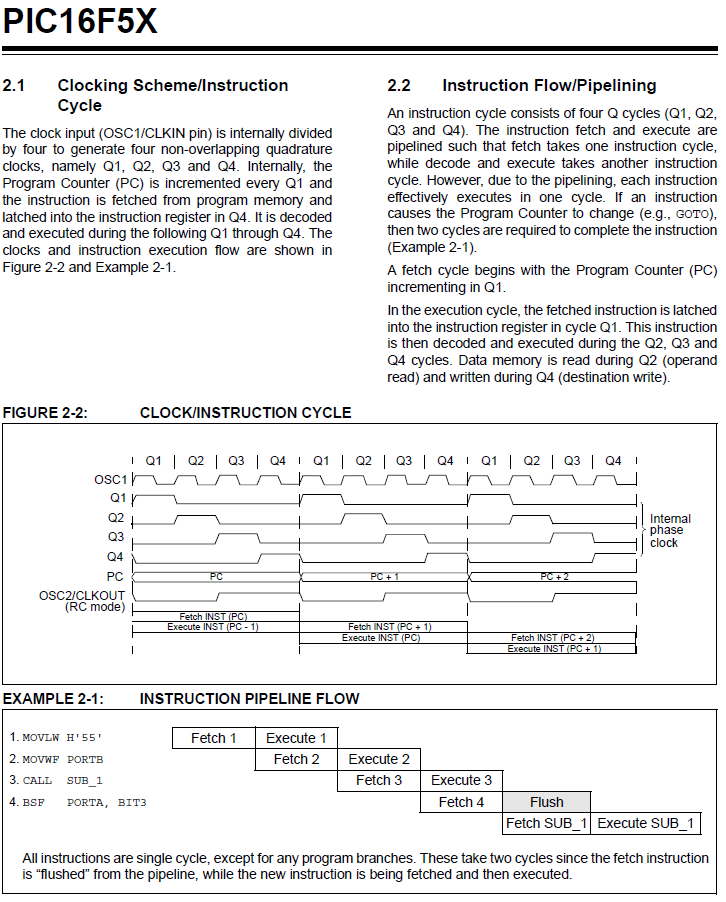

Jason,
The helpful illustration of how the clock divider works with instruction pipe lining would be a good one to include here too. Do you know which illustration I'm referring to?
Yeah i think 1 minute:
This shows you how everything works.
Here ya go:

Anyway - back to the original question :D
The clock oscillator on a PIC (or other processor) looks like a fairly rough sinewave on a scope - it's also important to use a x10 probe, as the scope will often stop the oscillator otherwise.
Basically, if there's anything shown on the scope, it's working OK.
