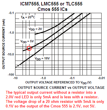

No. An LMC555 is a low current Cmos 555.
"Real Life" didn't look at the datasheet of the Cmos 555. With a 5V supply its typical output high current to a 2V red LED is only 5mA which is already current-limited without a series resistor. A series resistor would just reduce the current even more and reduce the already dim brightness.

Don't you have the datasheet for the LMC555? It shows an accurate formula for its output frequency and shows a graph of the output frequency with different timing parts.
The graph shows an output frequency of about 90Hz when the timing parts are 5k ohms, 5k ohms and 1uF like in your circuit. It shows 1 second pulses if the resistor values are increased to 500k ohms (use 470k) or if the capacitor is 100uF.

It shows an output of +5V which is impossible. The datasheet for a Cmos 555 shows that its typical output is only 5mA into a 2.0V red LED without a resistor. Your 20 ohm series resistor will have only 0.1V across it so the output of the Cmos 555 should be only +2.1V, not +5V.
