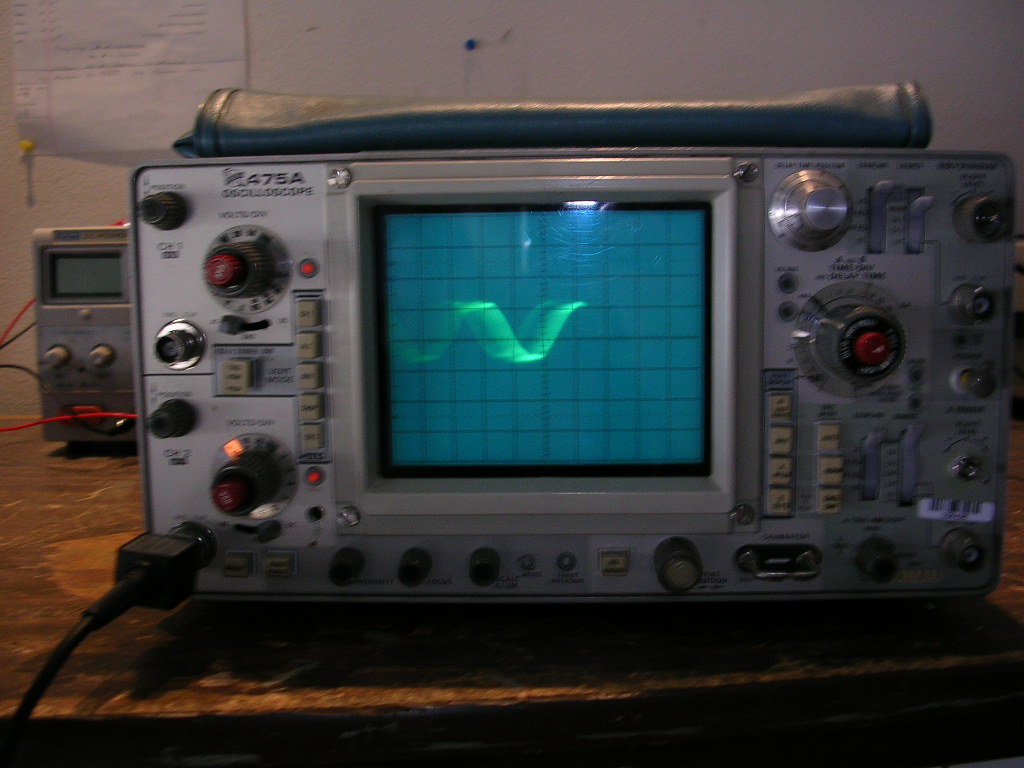

I just got a good bargain on an oscilloscope off ebay- a 250MHZ Tektronix 475A dual trace for $70 :lol: The way I see it, I can sell my other 20MHZ scope that I got for $80 and cover my costs :wink:
There is one problem with the scope though that can probably solved easily. If not I'll just resell it. The beam is stretched out, I don't know any other way to explain it. In one picture, the beam is not moving at all, so it should be a dot, not a line like you see. In the the other picture you can see the distortion of the waveform caused by the beam being stretched out.
So how do I fix this?

Zach,
I concur with Ruslk re the first photo.
In the second photo, it looks to me as though either the Horzontal amp is lacking in gain or the Delayed Sweep is faulty. Does the X shift move the trace?
Was the delayed sweep on when you took the photo?
If so, does the Delayed Sweep delay control move the trace?

Len, if you look at the sweep control knob, he has it in X-Y mode. I think this is intentional, as he should get a dot on the screen with no inputs, as he says.
Ron,
I was using a friend's computer and had limited time. If both photos are supposed to show only a dot, then there must be ripple in the Y amp and ripple or noise in the X.

Ron is right, I had it in x-y mode and I should be getting a dot, not a line.

1. I hooked up my scope to the + side of about 6 electrolytic supply caps, which I'm guessing is the supply rails as well. I found a triangle wave in the neighborhood of about 1 volt riding on the supply rails. The frequency was 125hz- because of the bridge rectifiers correct?

Yes, 1956 for a repair is impossible. The 475 came out around 1974 and the 475A around 1980 or so. The 475 and 475A are nearly identical -- the extra bandwidth comes primarily from tweaking up the output amplifier. So if you need a "hangar queen" for parts, a 475 should work about as well and be more readily available as more of them were made.
I'd suggest getting your test scope probe into the horizontal amplifier with the 475A in the X-Y mode and take a peek along the signal path and see where this spurious signal starts and stops to isolate the defective stage. It may be nothing more than the replacement of a decoupling cap in one of the supplies.

The scope works fine when it's not in x-y mode. It's like looking at a waveform made with a caligraphy pen held horizontal. I hope it's just one of the supply caps because I really have no idea what I'm looking at, there are a lot of boards on the scope. I'd have to get a repair manual.

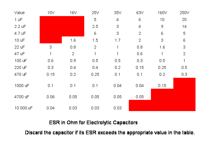

ESR = Equivalent Series Resistance.
My understanding is that it is resistance of the connections to the plates which can change with age due to (I assume) the aging of the electrolyte.
Here is a chart of the maximum ESR for normal caps (taken from my ESR Meter that I built as a kit)

The 475A is old enough that Tek may have considered it obsolete. Repair by them won't happen and new parts will be dicey. The scope DOES NOT work fine when not in the XY mode. The waveform that you displayed in your original post is the result of the problem that's messing up the beam in the X-Y mode. Since the vertical amplifier feeds the horizontal amp in the X-Y mode, you can rule that out as the culprit. The problem has to be in the horizontal amp.

I would agree ( as stated above ) that it is likely the supply and/or bypass caps. The scope is old enough that they are due for replacement anyways. Whenever this scope is listed at one of the refurb/recal places, they always state that these caps have been replaced. It is a nice enough scope to warrant a few hours and a few dollars worth of caps.
