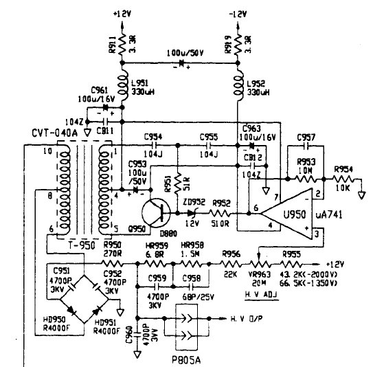

I've been searching quite a bit on the net and have come across the schematic of the HV supply circuitry.
The problem is that the CRT is dead, and there is no HV output from the transformer. I found that Q950 (D880) is frying, getting so hot it melts the plastic insulation washer.
I've also changed U950 (UA741CN) but with no luck.
I've removed the transformer and got the following resistances. Pin1-Pin4 = 0.3Ω, Pin4-Pin5 = 1Ω, Pin6-Pin8 = 330Ω, Pin10 is not used and is left open.
I'm getting all the right voltages (+12, -12) where they need to be.
My theory is as follows:
Although the very low resistance of the transformer inputs, I'm sure its driven at high frequencies therefore the impendence will reduce the current load. I think the circuit is not oscillating and therefore the low resistance is shorting through the D880 and causing it to burn, But I'm not sure? :confused:
I'm not sure where or what to check now? Which part of the circuit causes the oscillation to drive the D880?

The Schematic
Sorry, forgot to add the schematic.
I believe the scope is a copy of many other re-branded scopes. Like the following (indentical)
It looks like a crude 'blocking oscillator' so there's only the output transistor and the transformer. The 741 is used to monitor the output and adjust it to be correct.
Most likely problem is the transformer, which may have failed 'shorted turns'

Is there any way of testing the transformer to confirm? and if it is, could an new one be made up without have the specs for it? would there be any other way of powering the HV side?
