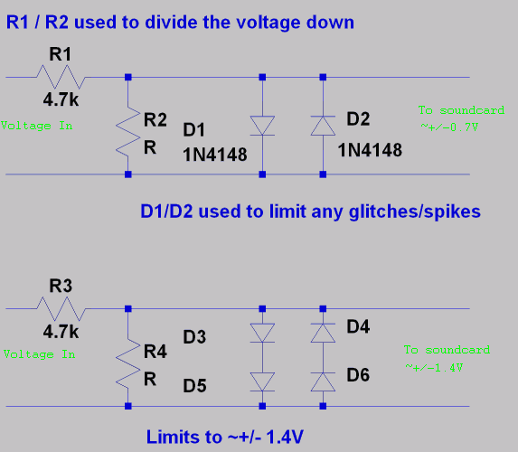

hey! i forgot the concept of SHUNT DIODE. I think a parallel connected diode is called a shunt diode. am i correct.?
Can you tell me the purose of the shunt diode and how this shunt diode protects the Circuits from any demage.?

There seems to be some confusion. Attached is how the diodes would be wired up. Top diagram (2 diodes total) limits the voltage to the soundcard to ~+/-0.7V, the lower (4 diodes) ~+/-1.4V.
The resistors should be selected to suit the input voltage range.

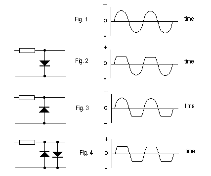

That is a circuit I always referred to as a Diode Clamp or Clipper circuit. The diodes will clip or clamp the incoming signal level to the forward voltage drop of the diodes or about .6 to .7 volt so if you have two in series about 1.2 to 1.4 volts. The problem is if you run for example a sine wave into it the waveform is clipped or clamped.
The same thing happens if you don't use the diode (the ADC maxes out) - except that it's rumoured that the soundcard doesn't enjoy it.
