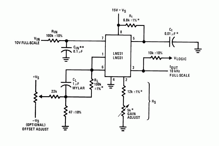

Before I got the time to learn PIC, I would still prefer to use readily available PCs, if I can find a way. One suggestion is to employ a simple VCO, so that the voltage level to be measured is converted into a corresponding frequency of an oscillator. The signal is fed to the line-in of the sound card. What we need to do now is to write a program, say in Visual Basic, to monitor the frequency and convert it back to voltage data.
How can I write such a program? I have the basic programming knowledge if Visual Basic, but I have no idea how to get the frequency values out from the sound card!

I agree with you and Nigel that a microcontroller with an ADC could certainly be programmed to be an analogue signal data logger. However my idea of employing a VCO as ADC is from an article titled
"VCO Transforms Sound Card Into Precision DC-Coupled ADC" at
I can see a benefit of this approach is that the VCO circuit could be easily isolated (say by a single photo-coupler) from the PC --- as needed in some applications such as that for dispalying the ECG signal. I would not give up PC either as I would like to do a lot of data manipulation on the PC.
The original circuit uses an IC XR-2206. I am thinking of one goood enough but with much simpler circuit using LM331.
Matlab has been used for the programming. Unfortunately I have facilities to do Visual Basic, but not Matlab, and I do not see any reason why Visual Basic could not do the same job!
This is where I got stuck ---- I need the advice how I could program the sound card wirh VB, or where I could get such information.
Could any one help please !!!
Olihou
Circuit of LM331
