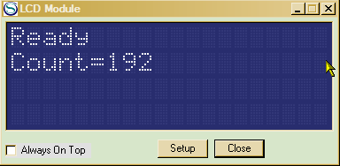

Look at this quickie, it works fine in simulation, it will give an idea what to do.
I will clean it it up and post it tomorrow.
AllDigital
Define SIMULATION_WAITMS_VALUE = 1
Define LCD_LINES = 4
Define LCD_CHARS = 20
Define LCD_BITS = 4
Define LCD_DREG = PORTB
Define LCD_DBIT = 4
Define LCD_RSREG = PORTB
Define LCD_RSBIT = 1
Define LCD_EREG = PORTB
Define LCD_EBIT = 3
Define LCD_RWREG = PORTB
Define LCD_RWBIT = 2
Dim tmr1low As Word
Dim tmr1high As Byte
Dim tmr1count As Word
TRISA = 0xff
Lcdinit
Lcdout "Ready"
'set tmr1 prescaler to 4, to divide the clk to 1mHz
T1CON.T1CKPS1 = 1
T1CON.T1CKPS0 = 0
T1CON.T1OSCEN = 0
'internal clock
T1CON.TMR1CS = 0
'disable tmr1
T1CON.TMR1ON = 0
start_loop:
If PORTA.0 = 1 Then
T1CON.TMR1ON = 1
Goto counting
Else
Goto start_loop
Endif
counting:
If PORTA.1 = 0 Then
Goto counting
Else
T1CON.TMR1ON = 0
'read tmr1 count
tmr1low = TMR1L
tmr1high = TMR1H * 256
tmr1count = tmr1high + tmr1low
Lcdcmdout LcdLine2Clear
Lcdcmdout LcdLine2Home
Lcdout "Count=", #tmr1count
'clear timer1
TMR1L = 0
TMR1H = 0
Endif
Goto start_loop
EDIT:
a sample run

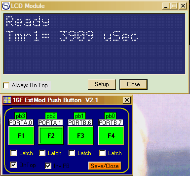

This program is a little tidier, with added comments.
When running in the OS simulator, reduce the 16mHz clock to 4mHz, you should find the the sim runs faster.
It also gives you more time to set PORTA.0 and .1 high, so the count is 'higher'.
Remember if you are too slow in pressing PORTA.1 after A.0, it is counting very fast and timer1 will overflow.
On my Forum Blog is a '16F ExtMod Push Button' external module for OS, download it, follow the install instructions on the blog.
Lets know how it goes.
'**** for SIM only
Define SIMULATION_WAITMS_VALUE = 1  '=0 or deleted for a PIC
Define LCD_BITS = 4
Define LCD_DBIT = 4
Define LCD_EBIT = 3
AllDigital  'PORTA digital i/o
Dim tmr1count As Word  'the timer1 is 16bit
TRISA = 0xff  'set PORTA as all inputs
Lcdinit
Lcdout "Ready"  'just show that the lcd is OK
T1CON.T1CKPS1 = 1
T1CON.T1CKPS0 = 0
'disable osc section
T1CON.T1OSCEN = 0
'select internal clock
T1CON.TMR1CS = 0
'disable tmr1
T1CON.TMR1ON = 0
start_loop:
If PORTA.0 = 1 Then
T1CON.TMR1ON = 1  'enable timer1
Goto counting
Else
Goto start_loop  'await PORTA.0 high
Endif
'timer1 counting
counting:
If PORTA.1 = 0 Then
Goto counting  'await PORTA.1 high
Else
T1CON.TMR1ON = 0  'PORTA.1 is high
'read timer1 count
tmr1count.LB = TMR1L
tmr1count.HB = TMR1H
Lcdcmdout LcdLine2Clear  'clear old lcd line2 display
Lcdcmdout LcdLine2Home  'set lcd cursor to start of line2
Lcdout "Tmr1= ", #tmr1count, " uSec"  'using the '#' convert  bin to ascii and display
'clear timer1
TMR1L = 0
TMR1H = 0
Endif
'await for both PORTA.0 and .1 to be low
While PORTA.0 = 1
Wend
While PORTA.1 = 1
Wend
Goto start_loop
End
