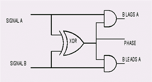

This is a way to detect lead and lag and phase, how to do it at 433 mHz is the challange.

thanks for the schematic. so using this schematic, the greater the length of the "phase" signal pulse means the greater the lag? but how do you know actually which one is lagging which if you were to feed it into a PIC for example. i tried drawing the signals but i dont understand.
if i want to measure minute differences in phase, presumably id want to be measuring the lag pulse length, which means measuring timing, which means having an extremely fast clock? unless i transmit at a lower frequency because i currently wanted to transmit at 433MHz because maplin sell some sexy 433MHz antennas that i think would recieve better than a piece of shabby wire lol.
