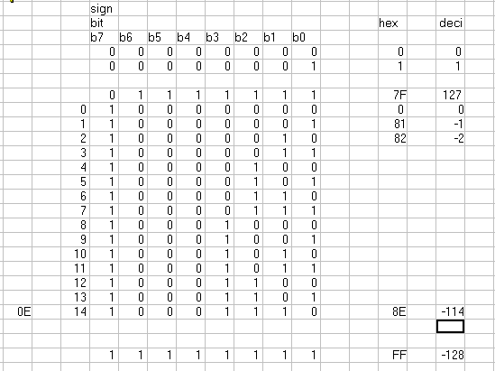

As Mike is in OZ,[bedtime] I'll help a little.
Look at this image.

i have seen the table and i have some questions about it:
1- here we added 0F + 7F, in the table why we start from 7F, what about 0F?
2- why we start with 0 digit directly after 7F why not 81 and then continue?
3- in the notes its written that (as a signed number,8EH represent -114, which is clearly not the correct result of 142; therefor, the OV bit is set) can you explain me this please
thanks
thanks a lot every body
..Thats one of the numbers you wanted to add
what about 0F?
Because 7Fh is a positive number.
If you add "1" to 7Fh you get 80h, not 81h
In the 8Eh value, bit 7 [ the sign bit ] is SET, so it represents a negative value.

You are working with an 8 bit value as a SIGNED value.
Bit 7 determines whether the value is positive or negative.
So effectively you are working with only 7 bits as the 'absolute' value.
As its a signed value, it can only have a range of +127 thru 0 thru -128.
If we consider the value of '142' which you have quoted and subtract 128 we get 14 [ 0Eh].
Using 8bit signed values you cannot have a positive value of greater than 127.
Using UNSIGNED values 7Fh + 0Eh = 8Dh [141 decimal]
IIUC your book does say that is a maths 'error' condition that should be tested for.???
