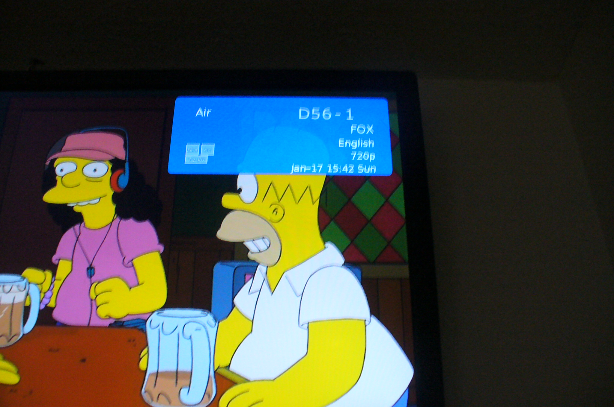

My TV gets its programming over the air.
There is a local channel 56, I watch it daily; a screenshot :
And there is supposed to be no channel 56 in 2021 ; another screenshot :
WhatTF is the U.S. FCC doing ? Can anyone explain ? :banghead:
Did you fail to notice when TV went digital?.
The TV 'channel' has nothing to do with whatever frequency the multiplex it uses might be on (and indeed a number of channels will use that exact same frequency) - the channel number is just an arbitrary number used for the EPG, and has nothing to do with frequency.

I did notice it, and the virtual channel numbering garbage had already started by then.
What do you mean by 'multiplex' ? Many same radiofrequency TV channels can transmit on the same if geographically far apart to not interfere .
This is over the air reception of channel 56-1
at my location, supposed to not exist over the air. Am not talking about cable nor internet nor subchannels.
Note that the channel info says it is in 720p resolution. That is a digital TV channel.
The existing channel names did not change in the transition to digital TV (around ten years ago), but they no longer have any relation to RF frequency.

The other way around. There is a physical channel which is the old RF channel. The RF channel can support, 9 virtual channels.
19; It could actually support 56-1, 56-100, 10-3 just about anything simultaneously. Scanning, scans the physical chnnels and determoness thier virtual channels.`
There is an analog and digital TSID (Transmit Stream ID) that's a unique identifier across the US that's assigned by the FCC. This is how the program guides work. 10-1 in california is different than 10-1 in New York. The TSID's will be unique.
Scanning scans by physical channel, determines which digital channel is associated with the physical channel. the scanner should also keep the TSID in case there are two or more virtual channels of the same number.
The remote should, but mine doesn't on my SMART TV. If you put in the physical channel of a non-scanned channel, it should find the virtual chanels. MY $50.00 DTTV converter box will work that way. The converter box will access the virtual channels if you input the physical channel.

That is a "virtual" channel, one item out of a multiplex stream, on some RF channel. There is no direct correlation between the two.
Look again at the link & section I directed you to earlier; a virtual channel can be on ANY RF channel:
If i set up a modulator at home for ATSC, I can pick what I want displayed and I can pick the RF channel. I would ghave an HDMI input for every stream and I probably should assign it a unique TSID (Transport Stream ID) that's unique for my location.
