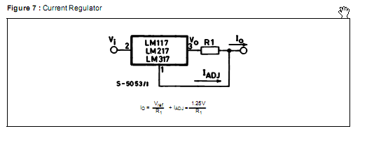

Have you considered using a LM317 as a current limiter in the +V supply input.?

If you use an LM317L (TO92 package) you can limit the current between 1 and 100mA by selecting the appropriate reference resistor value. (The LM317 can be used down to 10mA)
The formula for reference resistor: VR(Ω)=VRef(V)/IRef(A)
For your application (4-20mA) use VR=1.25/0.02 - VR=62.5Ω.
Add the current used by the transmitter circuit to gain the maximum output current.

What about reverse connection? Or accidental connection to mains or some power source when/if the wires get munched? I would just use a 50mA fuse (maybe 2) and a tough bidirectional zener (transorb?) about 10v in parallel with the sense resistor. That should save you from all possible overload situations.

The LM317 may be a nice trick for me, but since I am going to get energy from a battery, it could be even better if I get an LM317 equivalent with high efficiency,
Do you know any equivalent with a higher efficiency ?

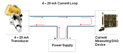

Yes, I know, it's a 10 year old thread . . . But the problem wasn't really covered, so here goes.
The problem is protecting the analog input (current measuring DAQ Device in the graphic below) in a 4-20mA, 2 wire, loop powered current loop. The transmitter (mislabeled transducer in the graphic below) is the loop current regulator, and there's the typical external 24Vdc power supply:
Somehow there's a short across the terminals at the 4-20mA transmitter so it's current regulating function in the loop is nil. The short puts the 24Vdc directly across the dropping resistor at the analog input. Dropping resistors are not power resistors, they're light duty little precision resistors capable of handling up to 25mA (maximum fault current indication) because 4-20mA loops aren't supposed to go higher than that. Some AI's still use discrete, external dropping resistors wired across the AI terminals, and if an external dropping resistor burns out, it's replaceable. But more and more AI's are going to integrated dropping resistors that are not replaceable, so a short at the transmitter now creates an out-of-commission AI.
Some Distributed Control System (DCS) AI's incorporate 50mA fast acting fuses on each AI to protect the AI.
